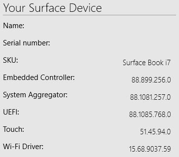

    Question is did my firmware actually install properly? Judging by driver dates and the fact that sleep is still broken, I don't think so.
    To see the actual firmware version (not the driver version), shutdown the system, then press power+vol up to enter System UEFI. There you can see the firmware version.
    Here is a picture of what you directed.  How do we know if this was the latest?  There's no dates listed just version numbers (I hate the fact that the pics show up sideways)
