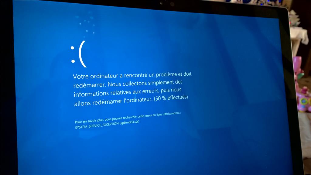

    2015-12-30T13:17:16+00:00
    Again and again and again crash. With latest beta intel Driver :(
