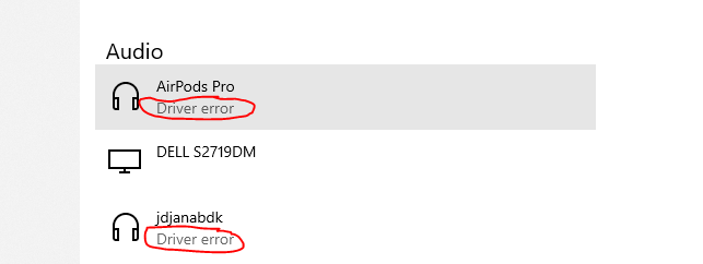

    2020-06-01T04:31:15+00:00
    Thank you, this worked for today. just like every time I call tech support and today it works. So I will let you know tomorrow or in a phew days if it still works. It often happens that the next day or two days later it goes back to not working. I really do not appreciate when this happens during work hours. So, even with the airpods "working for now" both airpods (pro and regular) still display "driver error" beneath the devices.
    I was offered by the company that they would send a new machine because if those drivers are not working, I do not want to find out what also does not work in the near future, specially in front of my co-workers and boss.
    I truly do not want another device because I know it will come with a whole new set of problems that I do not want to find out about. They refuse to either give me a different model or give me my money back, so I really still cannot recommend this product of company to anyone. It took a blogger to fix an issue that the same tech support guys could not fix. Again, that does not give me confidence in the product at all.

    2020-06-01T01:08:45+00:00
