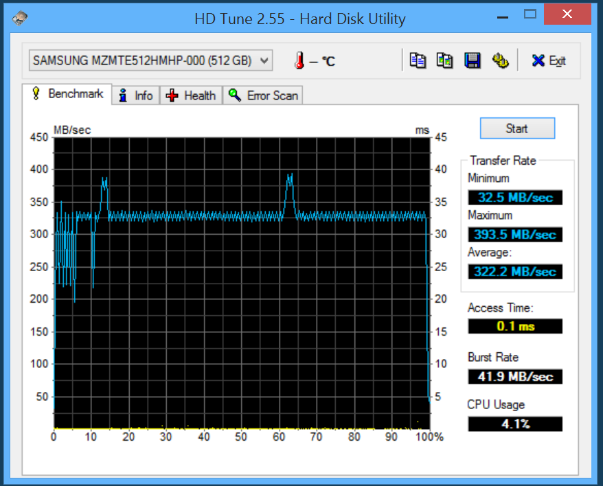

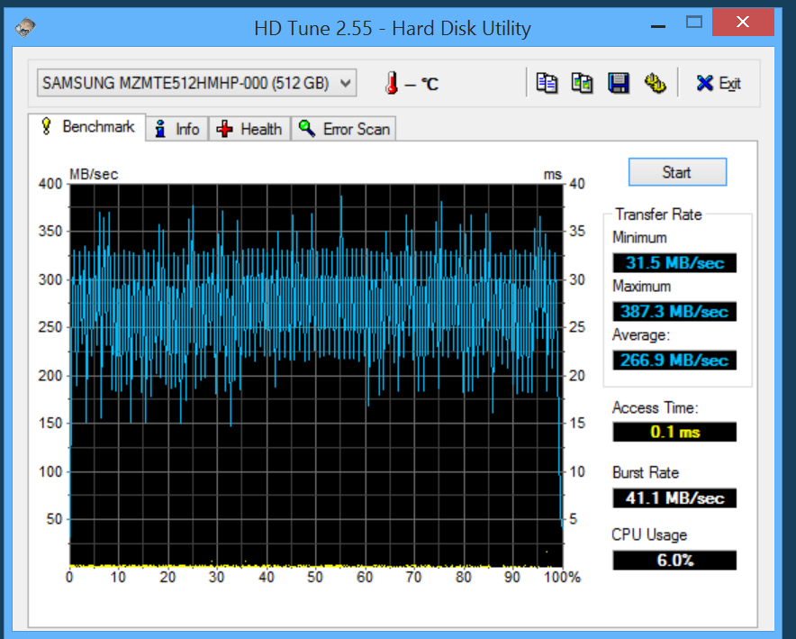

I've just had to update the firmware in another device that had a Samsung 840EVO SSD because they had a serious firmware bug with it.  Out of curiosity I tested the Samsung drive in my Surface Pro 3 and it looks like it has exactly the same issue (the SP3 drive is closely related to the 840 series I believe, but an OEM version.
The test is simple, just look at the read rate across the drive.  Older data (OS, installed apps) suffered from terrible read performance after a month or so.  Newly written data is fine.
As you can see, much of the drive is down to 50MB/s now.  It should be a fairly level line right the way across at about 350+MB/s.  This test was run with AC power connected and nothing else running.
If this is the same issue as the 840EVO, the good news is it can be corrected with a firmware update and refresh of the data.  Bad news would of course be Microsoft need to look into it first, then get the Samsung engineers looking into it.
