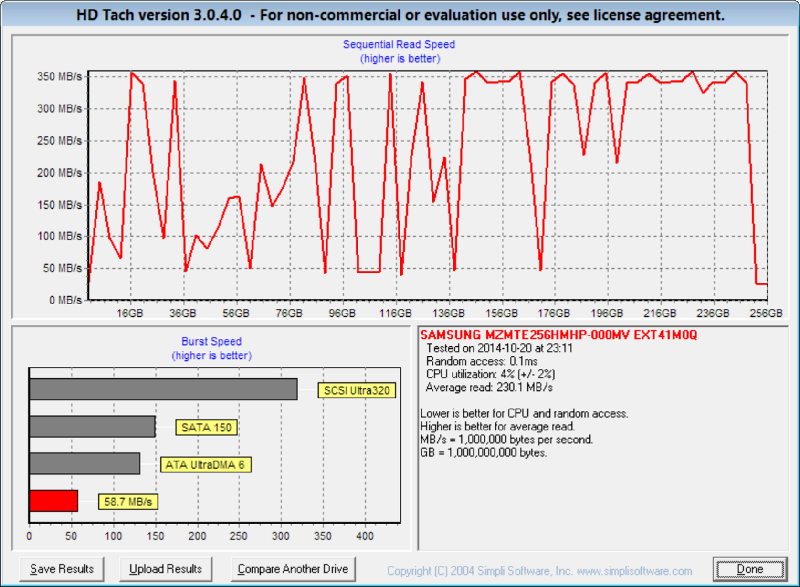

I've just had to update the firmware in another device that had a Samsung 840EVO SSD because they had a serious firmware bug with it.  Out of curiosity I tested the Samsung drive in my Surface Pro 3 and it looks like it has exactly the same issue (the SP3 drive is closely related to the 840 series I believe, but an OEM version.
The test is simple, just look at the read rate across the drive.  Older data (OS, installed apps) suffered from terrible read performance after a month or so.  Newly written data is fine.
As you can see, much of the drive is down to 50MB/s now.  It should be a fairly level line right the way across at about 350+MB/s.  This test was run with AC power connected and nothing else running.
If this is the same issue as the 840EVO, the good news is it can be corrected with a firmware update and refresh of the data.  Bad news would of course be Microsoft need to look into it first, then get the Samsung engineers looking into it.
Perhaps some other people could run the test too, and post results.  Remember the drive needs to be a month or more old, so that the data can have been sitting there only being read during that time.

    Is there really nobody else who can check their month or two old Surface Pro 3 and make sure the SSD is working at full speed?  Either it is just mine or we all have a problem.

    Well, to me, it does look like there is a serious performance issue here.  If you read the AnandTech article you will see that it is an issue with the flash memory cells changing voltage over time and the firmware not correctly compensating for it when it reads old data.  I'd have to guess that your SP3 was made at least a month before you got it and all the data on it will have aged during that time.  As you install fresh data and apps and updates more of it will be refreshed and look like my graph where more of it goes faster (350MB/s+).  But then over time the OS files and apps like Office and Visual Studio that are mostly static files will age again and slow down.
    To test this theory I will run the tests again, with HDTach and any other similar tools I can find.  And then I will use an app that reads and writes back every block on the drive, refreshing them all.  Either there will be no difference or the speed will increase across the drive..
    I will do that as soon as I can and post the results here.
    I the mean time, if anyone else can post the results for their own drives that would be most helpful in finding out if we all need a firmware update to boost performance, or if it's just me with a potentially faulty example.
