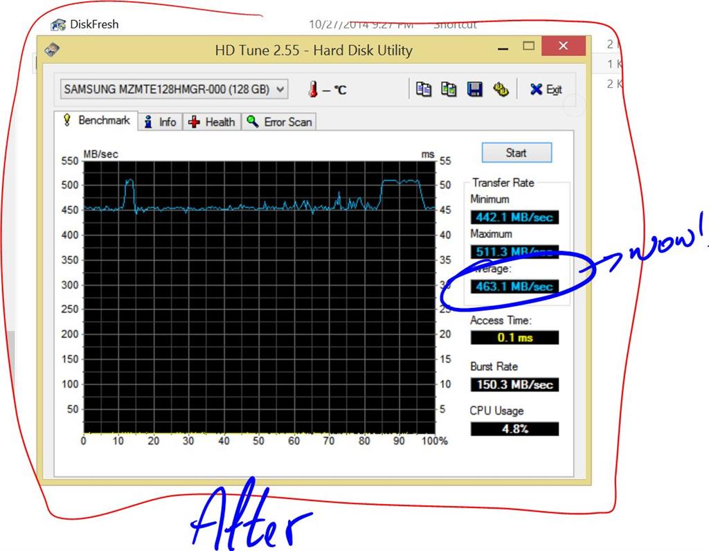

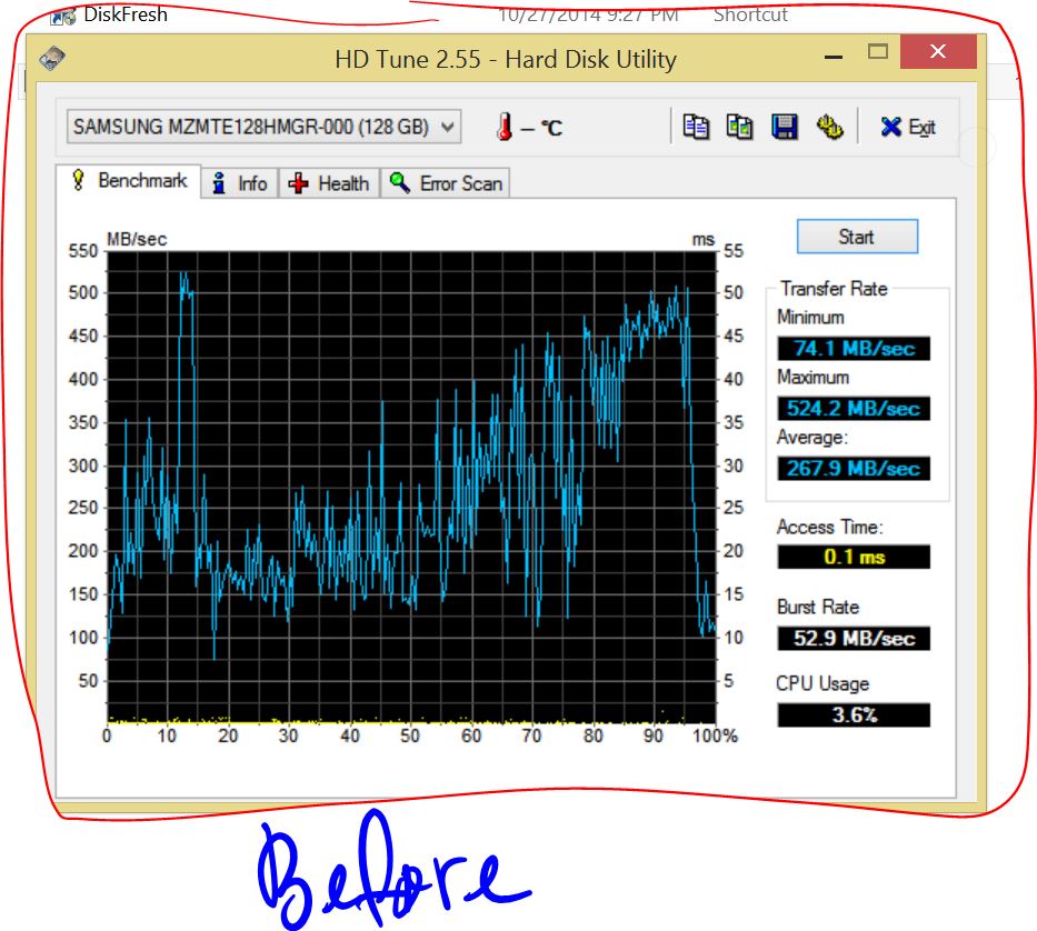

    Here is my SSD before Samsung's update
    and the below is after
    I'm impressed with the result.

    2015-02-03T16:24:53+00:00
    The frist pic is a benchmark after the last fw update.
    the second one was before the fw update.
