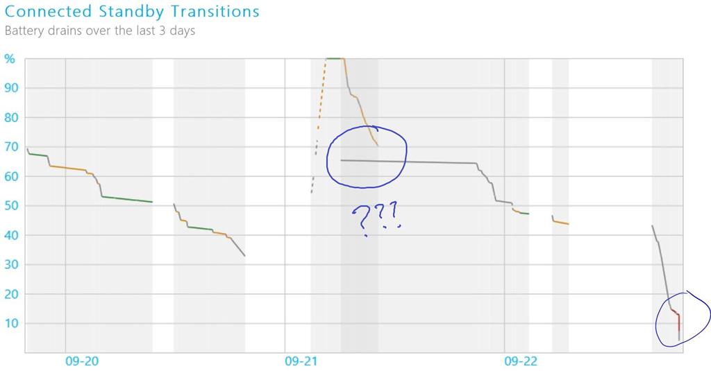

    2015-10-21T23:54:20+00:00
    I have noted this issue as well. Because it affects internal timestamps of logs, it corrupts them/makes them less useful for debugging purposes. Example artefact below from a Sleep Study log. (From "Need Data from folks experiencing sleep/battery drain issues on Windows 10" thread.)
    As a small footnote, I want to say I totally called it. :)
    "#2 There is a flaw with the Hibernate code or RTClock on the SP3"
