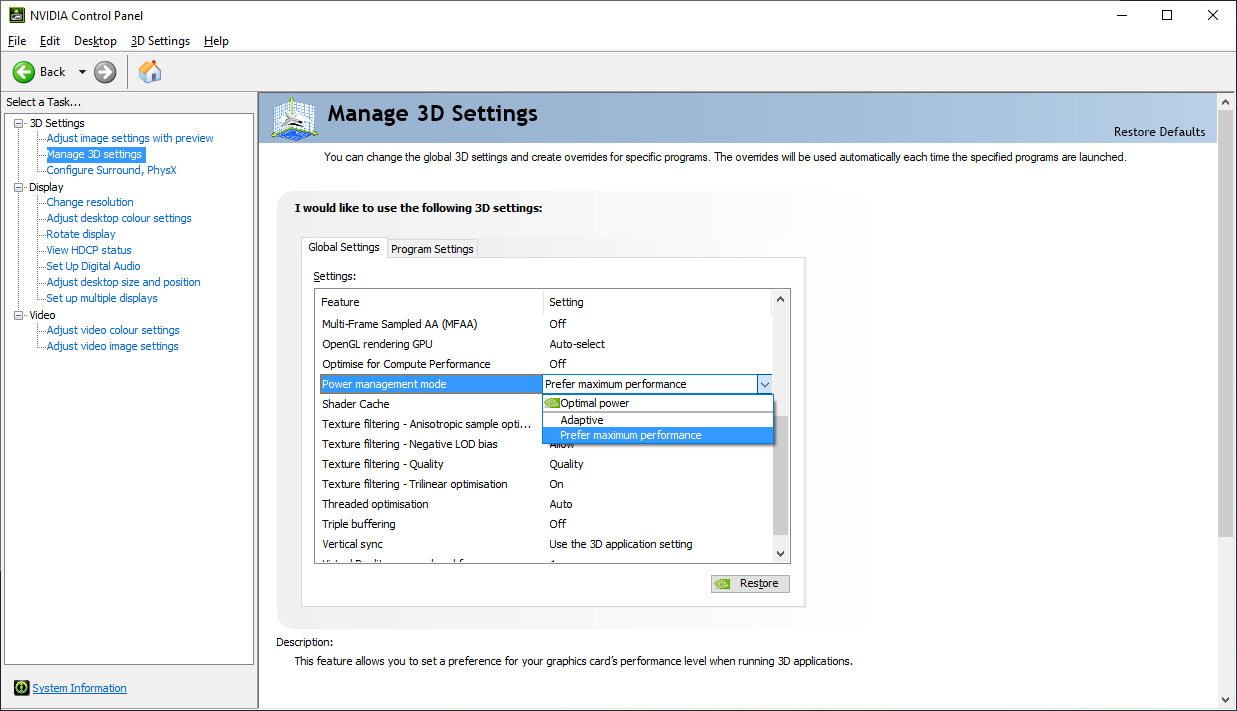

    2019-06-28T12:11:20+00:00
    Well, I'd love to know what's changing the power mode in detail, I wish to have a try. I really need a temporary solution because I need to use Photoshop for a huge task recently.(hard to be done without dGPU )
    Thanks!
    I'm at work at the moment and have actually left my Surface Book 2 at home, so this screen shot might look slightly different on there than on my desktop machine. But to change the Power Mode, open up Control Panel and launch the NVIDIA Control Panel.
    Once that's open select 'Manage 3D Settings' on the left hand side. Scroll down the Settings box until you find the Power management mode line. From here you can change the preference.
