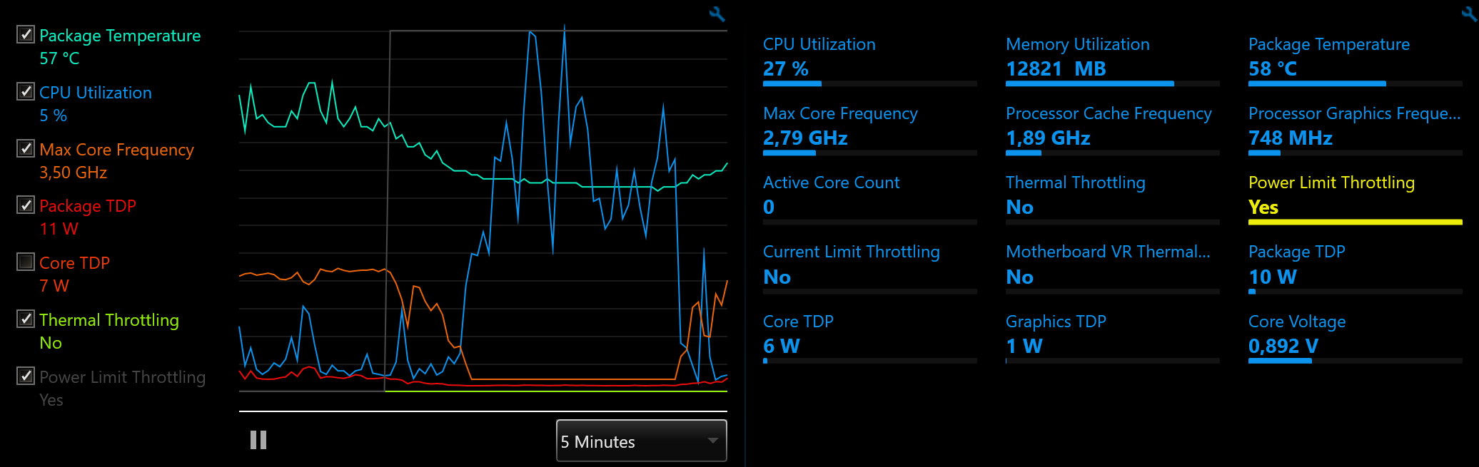

    2018-08-14T07:36:21+00:00
    I have the same issue and can also confirm that ambient temperature has a big impact on how the SB2 performs.
    Below is a graph which shows how the CPU Frequency falls down to 0,4Ghz for a couple of minutes (orange line). You can see that there is not much stress on the cpu and the package temperature is fine. I'm usually using VMWare but the issue also occurs if i'm working in Visual Studio on the host. It happens almost always if using VS and playing video stream.
    The machine is not usable for any kind of serious work, unless you are from arctic region..
    It is Surface Book 2 15", GTX 1060, 1TB, 16GB, Model 1793, 1813
    Lot No.: 1803
    bought in EU, german keyboard layout
    I've reinstalled windows and drivers numerous times. I've switched to the Preview Ring and then received all sorts of driver and surface firmware updates. Nothing helped, the issue is still present.
    Of course I've created support ticket and had MS tech representative logged in and I've demonstrated him the issue. After that they have blatantly ignored all my emails for the past two months!
