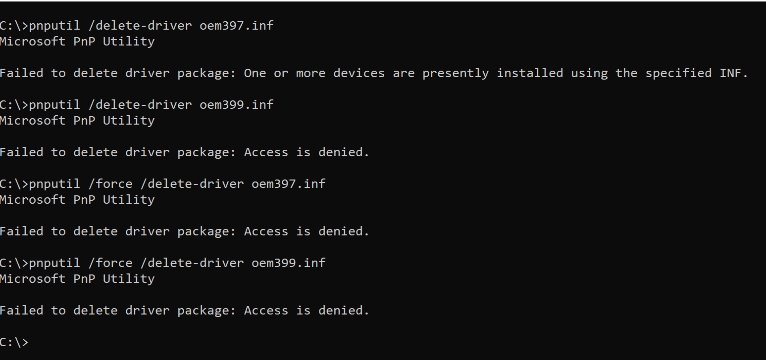

    2024-01-08T04:24:06+00:00
    This worked for me: https://www.urtech.ca/2021/11/solved-core-isolation-memory-integrity-incompatible-drivers-wdcsam64_prewin8-sys/
    1. RIGHT click on the START button and select WINDOWS TERMINAL (ADMIN)
      • If you are on Windows 10, select POWERSHELL (ADMIN)
    2. You can then list all of the drivers on your computer using pnputil /enum-driversand find the one with WDCSAM64_PREWIN8.SYS or you can just look at the error message.  In my case the driver that needs to go is OEM26.INF
    3. Uninstall the driver usingpnputil /delete-driver oem<XX>.inf
    You do NOT need a reboot so you can immediately retry to enable CORE ISOLATION and you should see a prompt to reboot once Core Isolation > Memory Integrity is turned ON.
