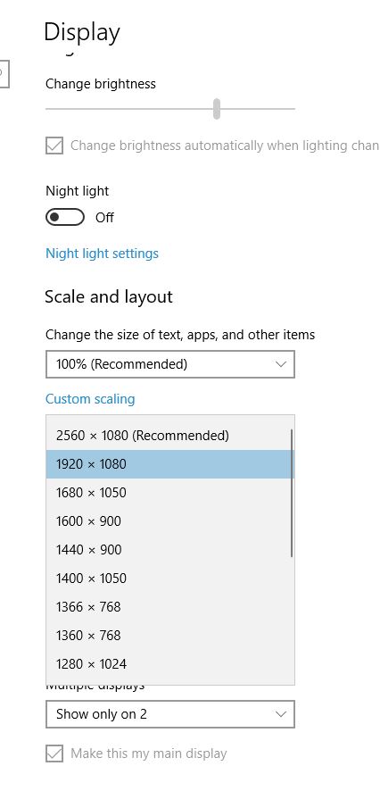

Last year I had purchased a brand new Samsung 29" ultra-wide curved LED monitor S29E790C to use with my older Surface Pro 2, and it worked like a charm. I would have it set to only display on the external display, and the graphics ran smoothly. However, much to my dismay, when I bought a brand new Surface Pro 4 (256 GB, i5, 8GB RAM model), the external monitor will, under no circumstance, adjust the native resolution properly.
The maximum option available is the 1920 x 1080 (recommended), and it's getting pretty frustrating trying to multitask using a 21:9 monitor with fat 3" black bars on either side of the active display area. I am using a regular Mini DisplayPort to HDMI adapter cable, which I have eliminated as the cause of the issue -- tried swapping it out with the other 4 identical ones I have as backups. I have heard tales of others experiencing the same exact issue with the newest design of the Surface moving to a 4:3 resolution in later models. Any input is appreciated.

IT WORKED!
I used the display port on my LG Ultra Wide (29UM55-P), instead of HDMI, and connected it to the mini display port on the Surface Pro 4 and now I have the native resolution (2560 x 1080) again on my LG.  Looks fantastic!
Here is the cable I used:
http://www.amazon.com/Cable-Matters-DisplayPort-Thunderbolt-Compatible/dp/B00C7RJQPY?ie=UTF8&psc=1&redirect=true&ref\_=oh\_aui\_detailpage\_o00\_s00
If you have a monitor that is not working with HDMI-to-MiniDisplayPort adaptors on the Surface Pro 4 I recommend going display port with cable.

    I just purchased a LG 34UM61 and connect to my SP4 connect to MS Dock.
    I shows that I can choose the recommend 2560 x 1080 , but when I choose it, it goes right back to 1920 x 1080.
    I can't use this resolution, as all my app are now stretched.
