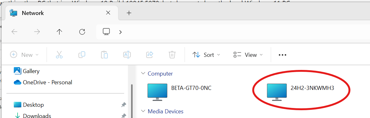

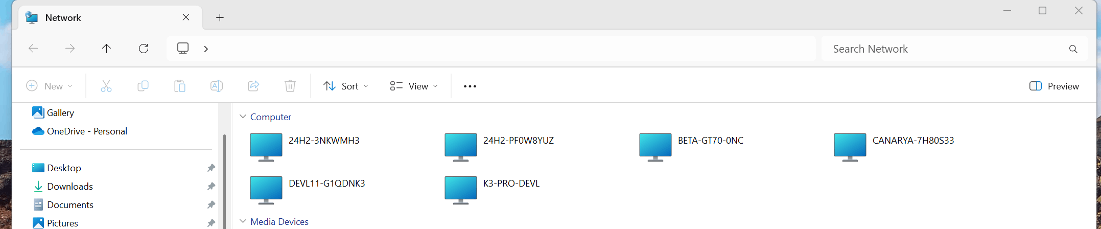

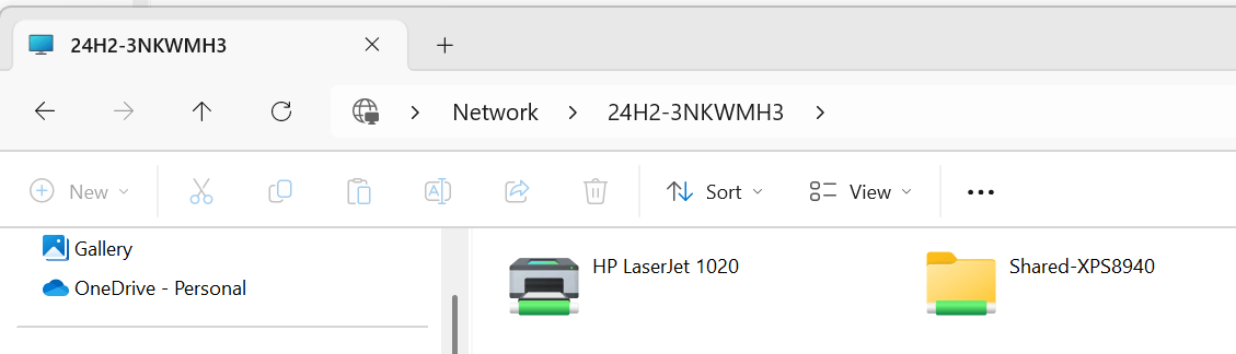

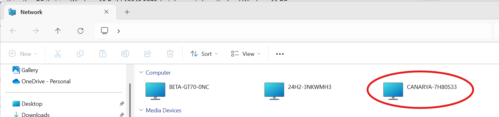

    @GazzaGDBB,
    26100.2033, is one update behind mine, the problem I described was happening with Build 26100.2152 which is the latest 24H2 update in R.P..
    All the other machines on my network are on 23H2.
    Sorry, I don't have 26100.2033 anymore, so I cannot check out the same configuration you have.
    I may have another PC where I can install 26100.2033 and see what happens. πŸ€·β€β™‚οΈ
    From your description you don't see any of the other PCs on the network from the one with 26100.2033.
    Edit:
    I got one machine with Build 26100.2033, sorry I cannot reproduce your problem, I can see all the other PCs on the network from the one with 24H2. (Showing below as K3-PRO-24H2) no problem from any of the other PCs either. πŸ€·β€β™‚οΈ
    Without seeing your exact configuration settings, I cannot even guess what could be causing your issue. πŸ€·β€β™‚οΈ

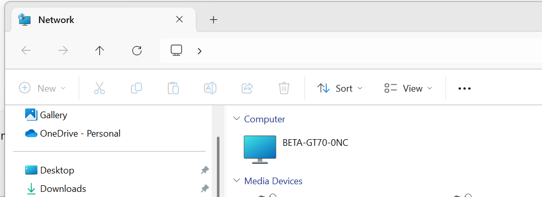

    2024-10-17T10:34:56+00:00
    Hi - thanks for taking the trouble to reply. However, your advice points have I believe been covered before in previous posts. I checked through all items again and still no progress. My build on the 24H2 machine is 26100.2033. The other 4 machines frequently connected on the network are on 23H2 and are working fine. It is just the 24H2 machine which is not showing devices under Explorer Network. I can however identify and link to the other machines (and the Netgear Router's Readyshare USB) using network shares and mapping. Below is a screenshot of Network devices when running DESKTOP-7RFCN5O under 23H2.
    The second screenshot is of what shows under 24H2 after all the advice and suggestions from you and others had been taken on. The only device showing under Network is the NAS.
    Of course, this may be something straightforward that I have overlooked. But it is mighty frustrating. Any ideas? Please note that I have tried everything suggested previously on this set of posts.
