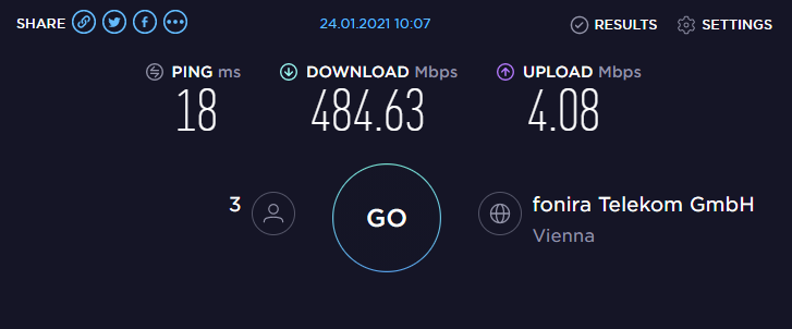

  3. mensa84 6 Reputation points
    2021-01-24T08:58:40.783+00:00

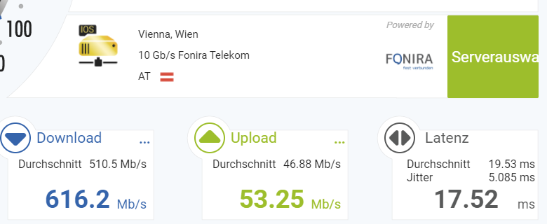

    I found out now, that I have nearly full upload speed at www.nperf.com to the same speedtest server as on speedtest.net
    Both tests are done in the same Browser (Edge 88.0.705.50) on Win 10 64 Bit.
    Do you think, that the technique used on speedtest.net is causing that problems?
    My upload speed in the Browser seems also to be fine again now. For example full 50 Mbit/s upload to Google Drive.
    But upload to uploaded.net is only about 4 Mbit. Do you think, that there are currently upload techniques which are causing that slow speed?
    I don't understand why nperf and Google Drive do work with full upload speed and speedtest.net and uploaded.net only with 4 Mbit.
