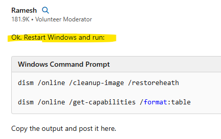

  2. NMcG 0 Reputation points
    2026-09-28T07:34:32.07+00:00
    The SSU 26100.9539 installed successfully and I restarted Windows as requested.
    I then ran:
    dism /online /cleanup-image /restorehealth
    This still fails with:
    Error: 1726 — The remote procedure call failed.
    I then ran:
    dism /online /get-capabilities /format:table
    This completed successfully and returned the full capability listing with no errors.
    So at this stage, RestoreHealth still fails with 1726, while Get-Capabilities completes successfully.
