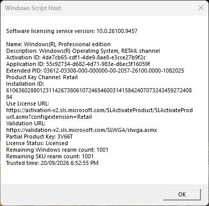

  2. DaveM121 935.7K Reputation points Independent Advisor
    2026-09-20T07:04:44.47+00:00
    1
    Where did you get your Windows 11 Pro licence was that pre-installed on the PC or did you purchase a full retail Windows licence from Microsoft or from a 3rd party retailer?
    Or is your Windows licence based on a previous Windows 7 or 8 licence?
    2
    Click your Start Button, type cmd then right click Command Prompt and choose 'Run as Administrator'
    Run or paste this command and hit Enter:
    slmgr.vbs /dlv
    Please post a screenshot of the resulting dialog

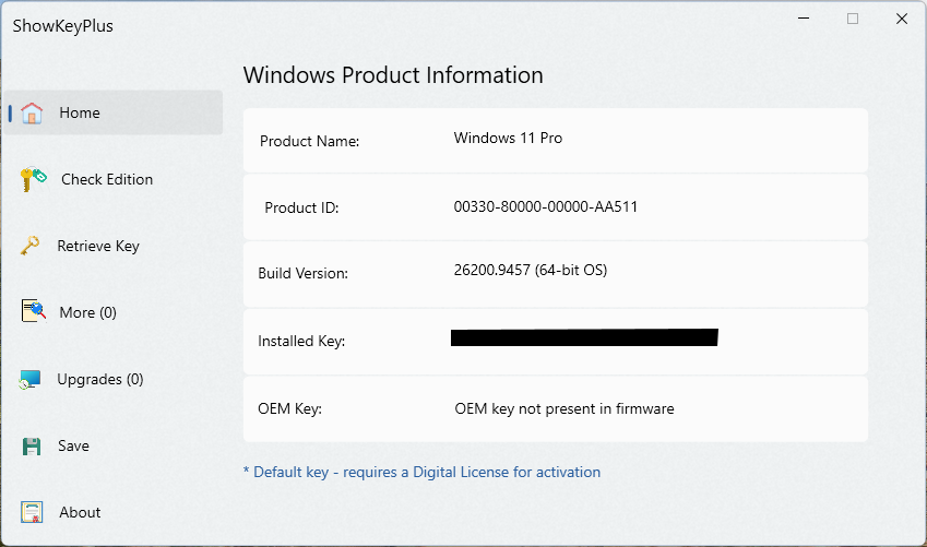

    Download the free ShowKeyPlus app from the Microsoft Store.
    Please provide a screenshot of that app window and please hide your product key in the screenshot.
