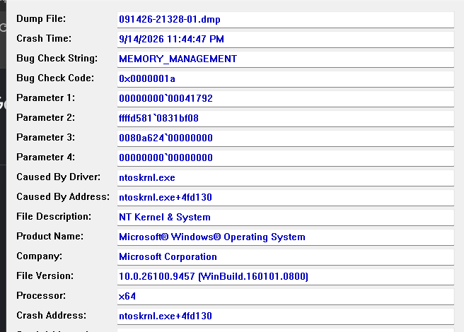

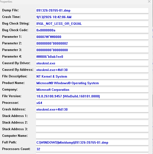

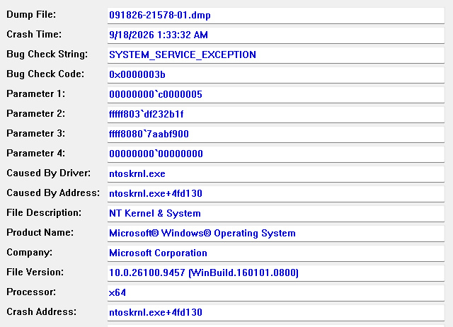

I've been getting constant bluescreens weekly or daily for over a month and I've tried everything I can to fix them but I haven't been able to.
Things I've tried:
  • Memory diagnostic
  • SFC /scannow
  • chkdsk
  • reinstalled windows
  • tried moving my ram, and switching it out
  • DISM Restore health cmd
  • Driver Verifier
    Nothing has worked; if I could figure out the root to fix it or what I need to replace that'd be helpful.Screenshot 2026-09-18 073925
Screenshot 2026-09-18 074049
Screenshot 2026-09-18 213604
Haven't done this before so left me know if anything else needs to be provided

    The dump summaries showing ntoskrnl.exe do not identify the real root cause by themselves. For these stop codes, the supported next steps are to focus on drivers, memory test results, recent hardware changes, Device Manager, and Event Viewer.
    Since SFC, DISM, chkdsk, Windows reinstall, and RAM reseating/swapping were already tried, the most relevant next path is:

    Based on the steps already completed, the strongest supported conclusion is:
    • If Extended Windows Memory Diagnostic reports errors, suspect RAM or memory-related hardware.
    • If memory passes and crashes continue after fully updating drivers, suspect a device driver or hardware/firmware issue, and focus on the device flagged in Device Manager or the matching System log events around the crash time.
