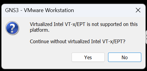

Hello Microsoft Support,
I am experiencing an issue with Windows 11 Pro where Virtualization-Based Security (VBS) and the Microsoft hypervisor remain active even after I have disabled Hyper-V, VBS, HVCI/Memory Integrity, Credential Guard, Virtual Machine Platform, Windows Hypervisor Platform, and related settings.
This is preventing VMware Workstation from providing nested Intel VT-x/EPT virtualization to my virtual machine.

Problem
VMware reports that virtualized Intel VT-x/EPT is not supported/available when trying to start a VM that requires nested virtualization.
