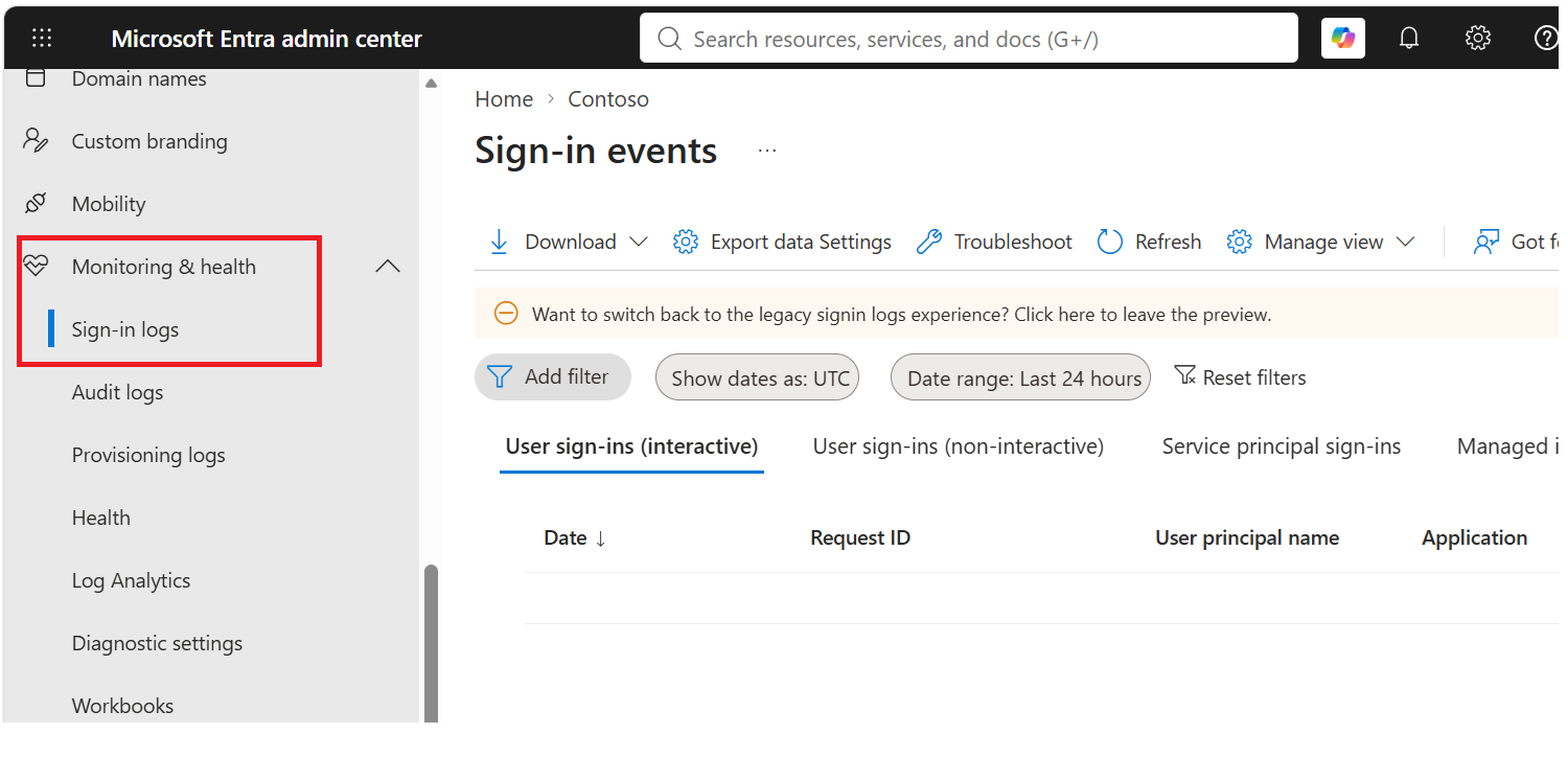

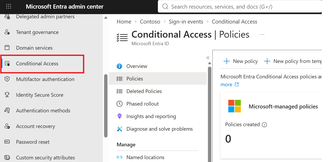

    Since your IT department is already looking into the issue, they can also check the Microsoft Entra sign-in logs for your account around the time of the failed sign-in. The sign-in details may provide more information about the cause of the failure. User's image They can also check whether any Conditional Access policies require an approved client app or an app protection policy for mobile access.
    For more information, see: Conditional Access - Require approved app or app protection policy - Microsoft Entra ID | Microsoft Learn
