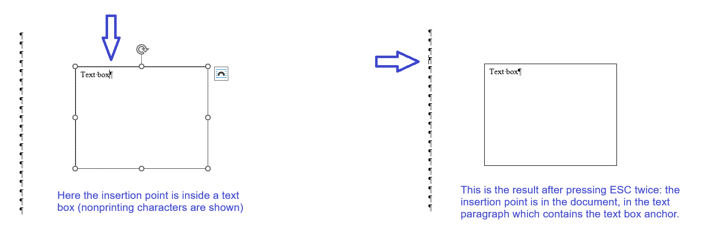

  1. Stefan Blom 352.7K Reputation points MVP Volunteer Moderator
    2026-09-18T07:34:44.5766667+00:00
    If the insertion point is inside a text box, press the ESC key twice to return to the anchor paragraph in the document. To get a clearer view, click the ¶ icon on the Home tab to display nonprinting characters.
