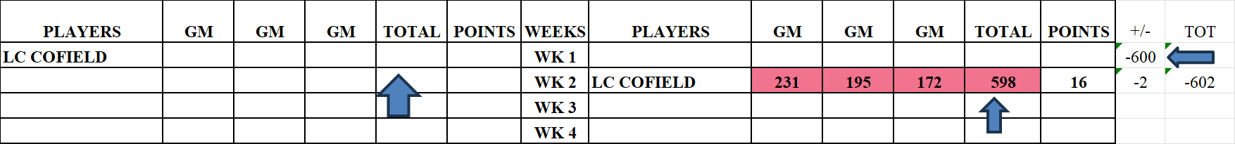

When using the following formula below in column N to calculate the value difference in column E & L, using a value of 600 to reflect a plus or minus +/- value difference in column N. IF(COUNTA($E2:L2)=0,0,ABS(SUMIFS($E2:$L2,$A2:$H2,"COFIELD")+0)-600)
The only way I can get the formula to work is to include) +0)-600) at the end of my formula to show a - (negative) value. I am also trying to resolve an issue, instead of showing a -600 value in column N when I have no data in cells A, B, C, D, H, I, J, and K, but to show a blank value until I have entered data in cells A - K,. Please see example above.

It looks like the issue is that your current test is COUNTA($E2:L2)=0, which only checks columns E through L. You want column N to remain blank until there is data somewhere in A:K.
Use:
=IF(COUNTA($A2:$K2)=0,"",ABS(SUMIFS($E2:$L2,$A2:$H2,"COFIELD")+0)-600)
This does three things:
  • COUNTA($A2:$K2)=0 → if A through K are completely empty, N is blank.
  • SUMIFS(...) → finds the COFIELD row/player and obtains the applicable total.
  • +0)-600 → forces the result to numeric and allows the negative difference to display correctly. For example, 598 - 600 = -2.
So with your example, TOTAL = 598, and the result in column N is -2 instead of -600 when the row has no data.
Note that if cells A:K contain formulas that return "", COUNTA can still regard those cells as populated. If that is the situation in your spreadsheet, use this version instead:
=IF(SUMPRODUCT(--($A2:$K2<>""))=0,"",ABS(SUMIFS($E2:$L2,$A2:$H2,"COFIELD")+0)-600)
That version checks whether A:K actually contain displayed values, rather than simply whether the cells technically contain something.

    Use a blank check first, then run the calculation only when the input cells contain something.
    Try this in N2:
    =IF(COUNTA(A2:K2)=0,"",ABS(SUMIFS(E2:L2,A2:H2,"*COFIELD*")+0)-600)
    What this does:
    1. COUNTA(A2:K2)=0 checks whether cells A2:K2 are all empty.
      • If they are empty, the formula returns "" so N2 stays blank.
    2. If there is data in A2:K2, Excel calculates:
    3. The +0 forces the result into a numeric calculation, which is useful when Excel may be treating a returned value as text.
    If the goal is to show the actual plus/minus difference from 600, including negative results such as -2, then this structure is correct.
    If Excel still behaves unexpectedly, use Formulas > Evaluate Formula to step through the formula and see which part is producing the result.
