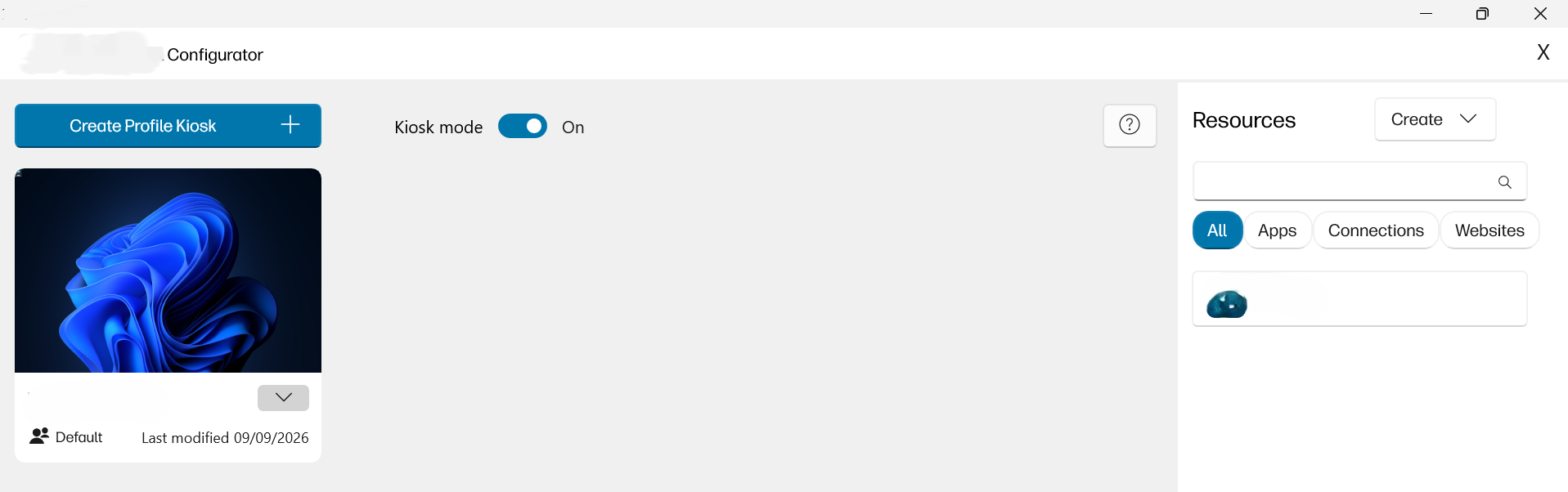

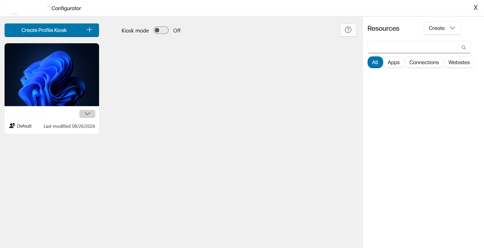

Here is an UI issue of our WinUI 3 application after we updated Win11 OS( Win 11 IoT LTSC Enterprise ) from "Win 11 OS build (26100.7623)" to "Win 11 OS build (26100.8875)":
The full screen config window is not correctly displayed in kiosk mode. The window now has a extra caption bar that will enable user to adjust the size of the window.
This UI problem cannot reproduced in non-kiosk mode in Win 11 OS build (26100.8875),
This UI problem cannot reproduced in Win10.
This UI problem cannot reproduced in Win 11 OS build (26100.7623).
What is the root cause of this problem and any solution to fix it programatically ? Thanks.
Wrong Window UI:
Expected Window UI:

    The extra Windows caption bar is visible above your application's own header. The build comparison narrows the investigation to the kiosk scenario, but it does not yet establish the root cause or a confirmed Windows fix.

    Separately, the Wrong UI screenshot contains a resource card below the filters that is absent from the expected screenshot. Is that resource card unexpected when using the same application data and settings, or were the screenshots taken in different states?
