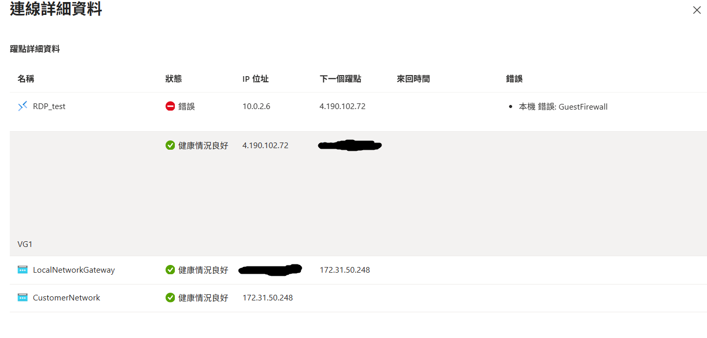

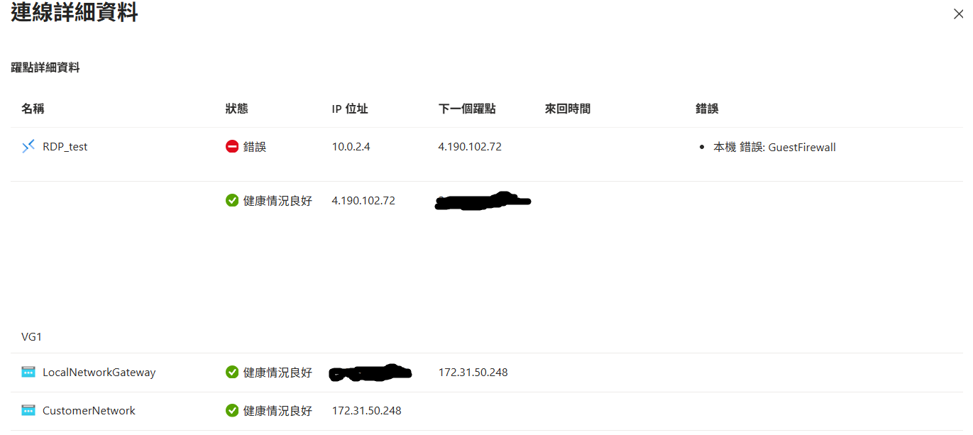

Azure Bastion Connection Troubleshoot reports the following for both targets:
Source Bastion instance: 10.0.2.4
Result: Local Error: GuestFirewall
I then increased the Bastion scale units so that a different Bastion instance was used.
New source Bastion instance: 10.0.2.6
The result is identical for both:
  • 172.31.50.248:3389
  • 172.31.50.249:443
The downstream hops shown by Azure Connection Troubleshoot are healthy:
Bastion -> Azure VPN Gateway -> On-premises VPN Gateway -> Local Network Gateway -> Target network

There is no NSG or UDR on AzureBastionSubnet, and the GuestFirewall error remains after the Bastion instance changed from 10.0.2.4 to 10.0.2.6.
