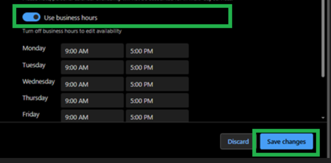

    5. In Bookings > Staff, open the assigned staff member:
      • Check whether Use business hours is enabled.
      • If staff should have their own schedule, clear Use business hours and set the working hours directly.
      • Save the staff record.

    1. Check staff availability hours
    • Go to Staff and edit the assigned staff member.
    • Review the weekly availability schedule and verify that it is not restricting your service hours.
    • As a test, set the staff availability to a wider range (for example, 6:00 AM to 10:00 PM) on all required days, including weekends if applicable.
      • Then allow the service's custom hours to handle the actual scheduling restrictions.
      • Additionally, please uncheck "Use Business Hours" toggle
