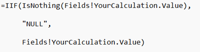

    and then test explicitly for null:
    If this is a DAX measure, also check whether the Report Builder query is supplying the same filters/parameters used by the Power BI visual. A measure can legitimately return BLANK() when evaluated under a different filter context.
