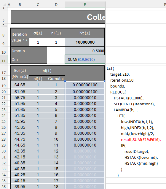

    Thank you — the screenshot and explanation clarify the problem.
    Since you confirmed that:
    • "D9" only increases in the positive direction,
    • "E11" also increases as "D9" increases,
    • and the values in "E19:E616" are never negative,
    then binary search is appropriate.
    However, there is still one important issue in the formula shown in your screenshot.
    You currently have:
    result,SUM(E19:E616)
    The problem is that this calculation does not use "mid".
    The "LET" formula calculates a candidate value called "mid", but Excel does not temporarily place that value into cell "D9". Therefore, if the formulas in "E19:E616" depend on the actual cell "D9", "SUM(E19:E616)" will continue using the current value of D9 instead of the candidate "mid".

    The remaining piece I need is the exact formula used in E19 (and copied down through E616).
    For example, if E19 currently contains something like:
    =B19/(C19+D9)
    then inside the binary-search formula it must become something like:
    =B19/(C19+mid)
    and the complete "result" calculation can then be built using the candidate "mid".
    So please post the exact formula currently contained in E19 (or whichever formula is copied down through E19:E616).
    Once we have that, we can write the complete formula you can paste directly into Excel. You should not need Goal Seek anymore.
