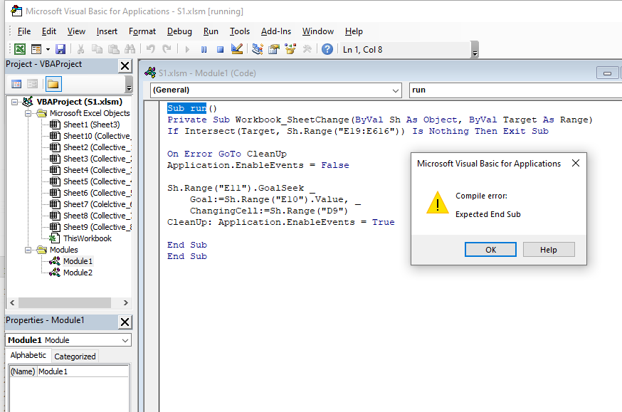

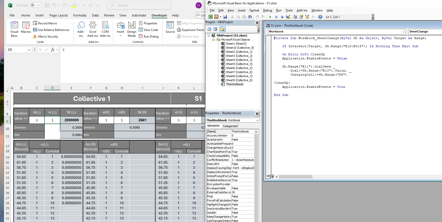

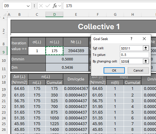

Requirement: I need to give value in D9 so that E10 (0.5) =E11.
I can do with "WHAT IF --> Goal Seek" .. for one time this is ok ..
But i do have 600 sheets like above...
I need to insert formula that must works automatically without "what if--> goal seek" formula.
That means it should automaticalle iterate D9 to satisfay E10 (0.5) =E11. when ever the tavle values changes in E19..E..616

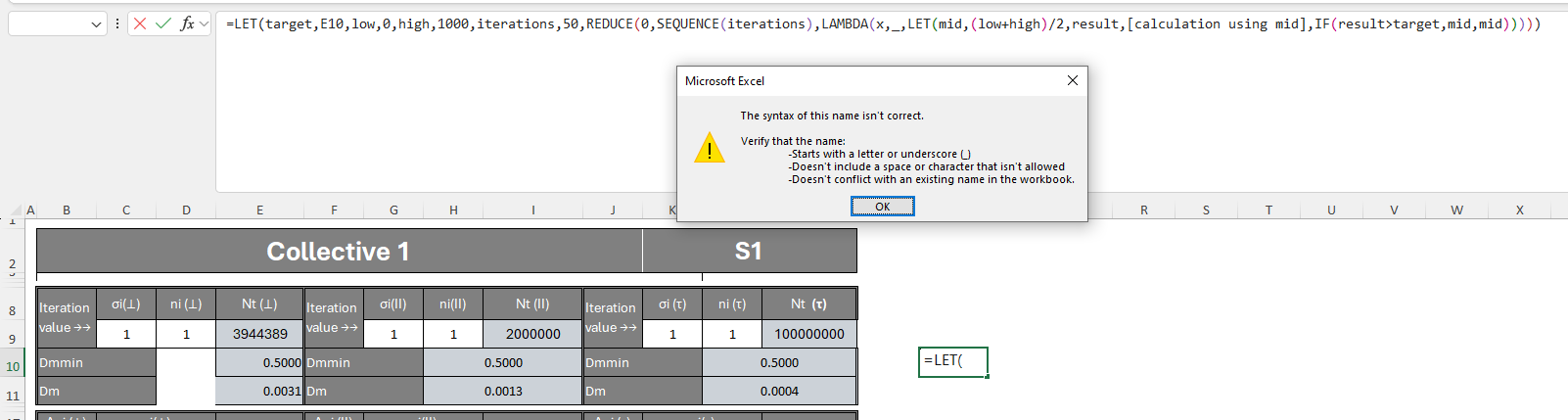

    However, you can do this with a formula if you express the calculation currently performed in E11 as a function of a candidate value for D9. A formula can then perform its own iteration, for example with LET and a binary-search algorithm:
    =LET(target,E10,low,0,high,1000,iterations,50,REDUCE(0,SEQUENCE(iterations),LAMBDA(x,_,LET(mid,(low+high)/2,result,[calculation using mid],IF(result>target,mid,mid)))))
    The exact formula depends on how E11 is calculated from D9 and the values in E19:E616.
