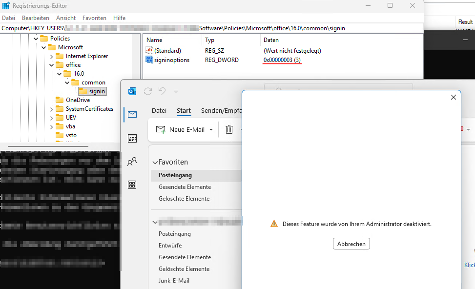

Environment:
  • Office LTSC 2024, volume licensed, managed via Active Directory Group Policy
  • Enterprise environment
  • Connected Experiences and related privacy/sign-in settings configured via GPO
Symptom: Since updating Office LTSC 2024 to Version 2408, Build 17932.20996 (released September 12, 2026, apparently an out-of-band build following the September 8, 2026 Patch Tuesday release, Build 17932.20976), Outlook displays the message "This feature has been disabled by your administrator" every time it starts.
Relevant configuration: The following registry value, not only, has been configured via GPO for a long time and has never caused this behavior before:
HKEY_CURRENT_USER\Software\Policies\Microsoft\office\16.0\common\signin
SignInOptions = 3 (DWORD)

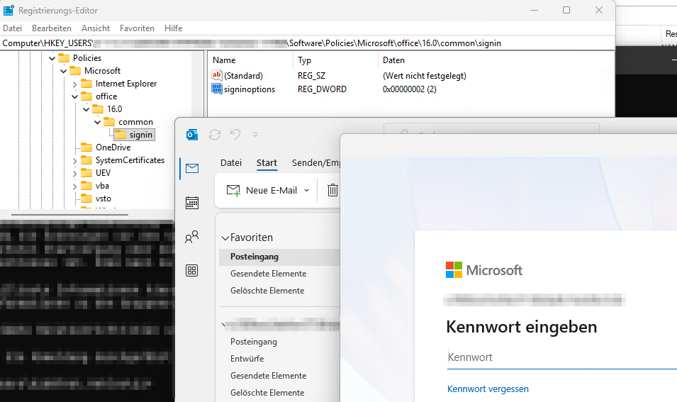

This policy is intended to block Office sign-in entirely and has been working as expected for a long time. It only started causing the startup error message after installing the above-mentioned update. If i delete this Key, the Signin Windows popup after Outlook starts.

    If permitted by your organization’s sign-in requirements, you may also test the following registry value with 1 or 2 for one affected user:
    Please test each value separately, restart Outlook, and check whether the behavior changes. Since this value is managed through Group Policy, your administrator may need to make the temporary change. If there is no difference, please restore the original value of 3.
