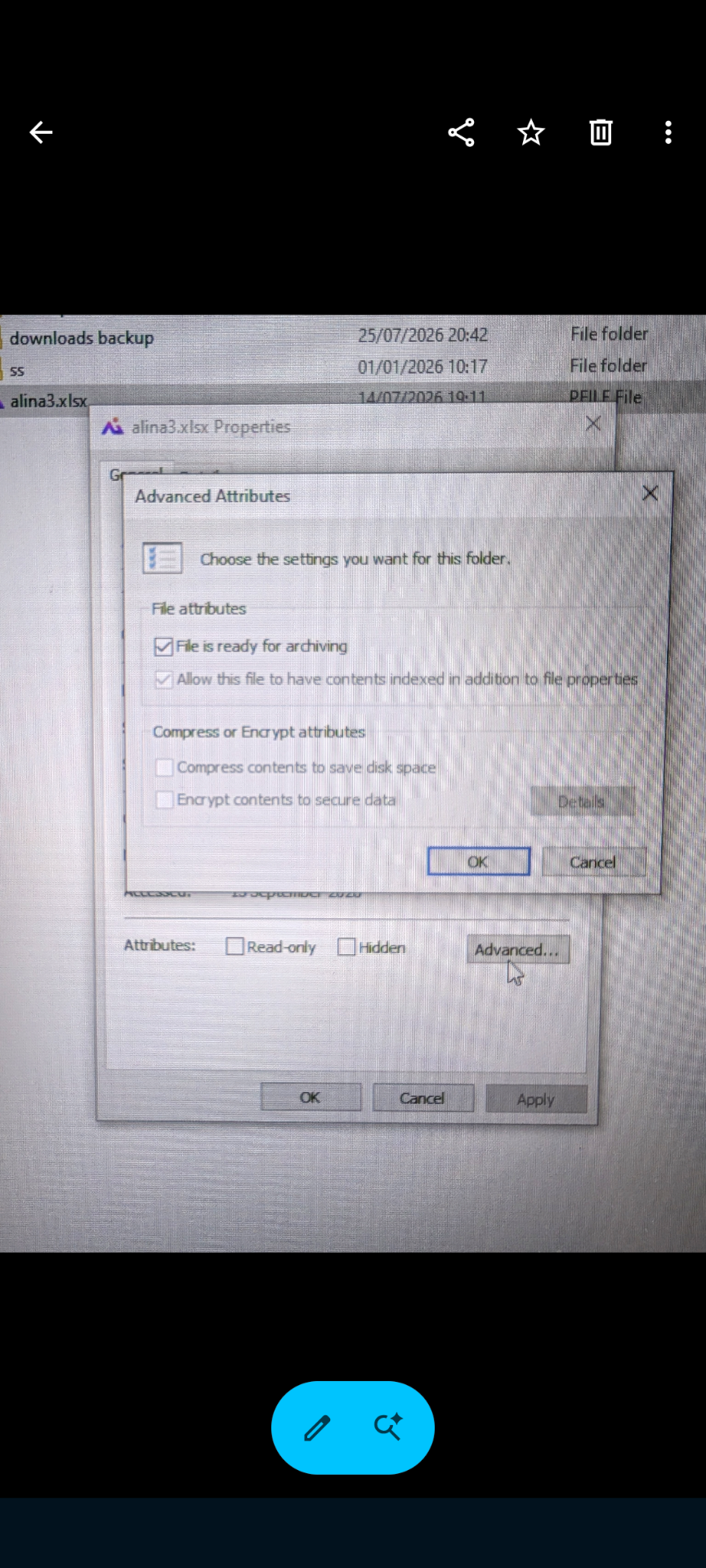

    Thank you for the prompt reply. I can confirm the Encrypt contents to secure data button is unchecked, see image below.
    1000036817
    The usb stick is not protected and does not need a password.

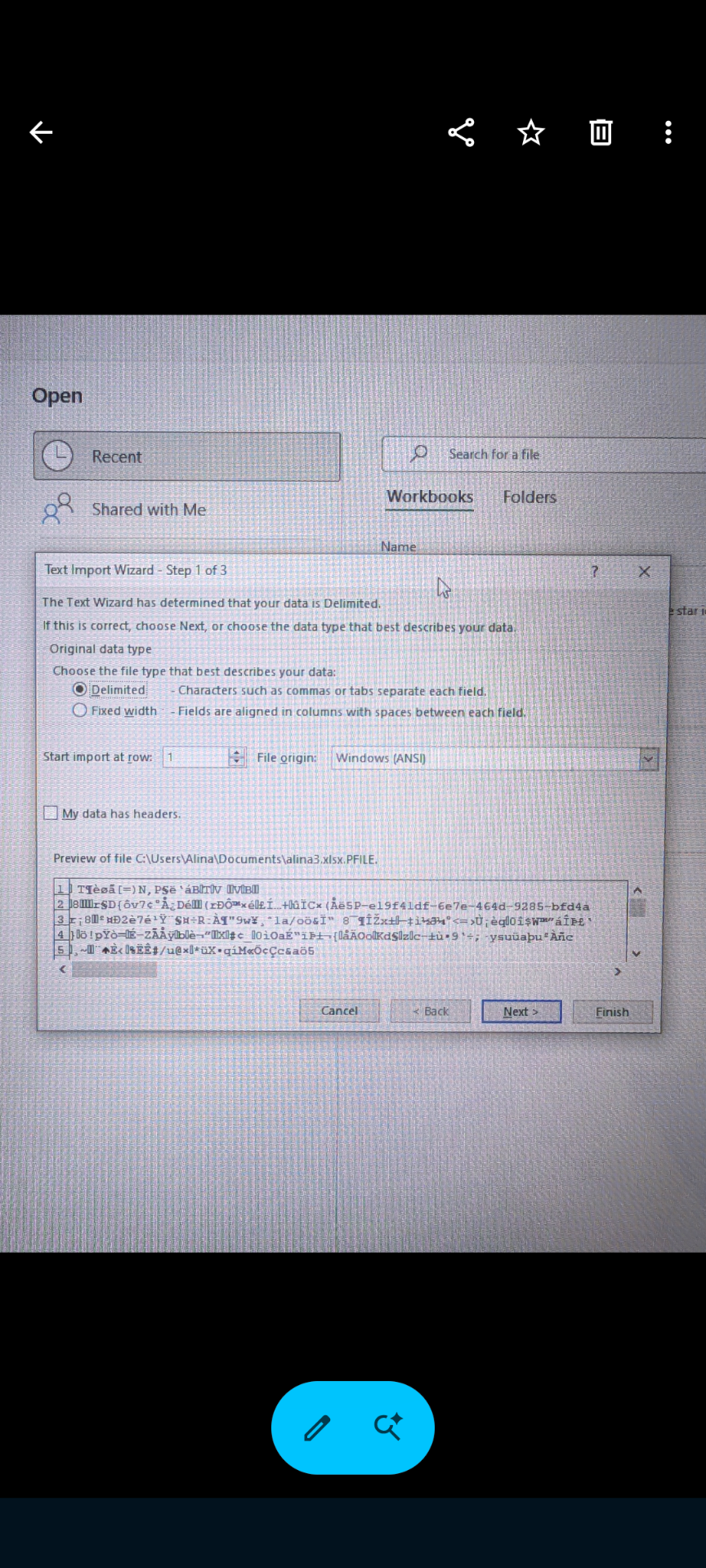

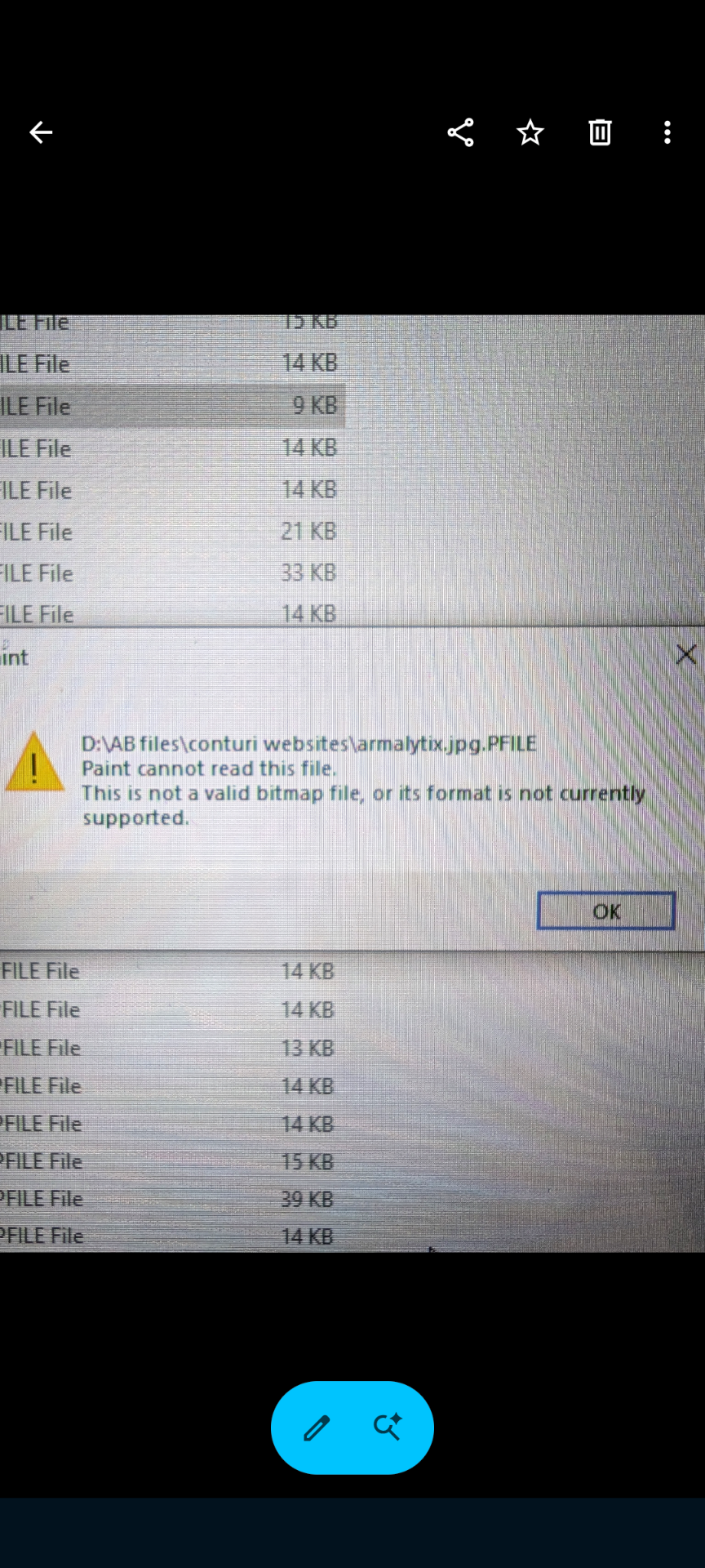

    The files I am trying to open are xlsx and jpg. Excell doesn't open it but attempts to import it, see below. The jpg files get an error referring to the .pfile format.

    I have followed your instruction to check the Details and find which certificate was used, unfortunately the Details button is greyed out.
