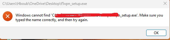

Hi, I tried to install a program in my pc but I am facing this error message " Windows Cannot Find file_name.exe Make Sure You Typed the Name Correctly "
I did every possible proposition in the internet ( changing setup name, disabling real time protection , antivirus , regedit, ,making folder options this pc ... ) but noting works
I appreciate any help, thank you.
WhatsApp Image 2026-09-12 at 11.53.50 PM

Your screenshot indicates the F5 VPN installer is on your Desktop inside the OneDrive folder, and that may be causing the problems.
Move the installer to another folder that is not synced to OneDrive, then right click the installer and select 'Run as Administrator', does the installer then run correctly.
