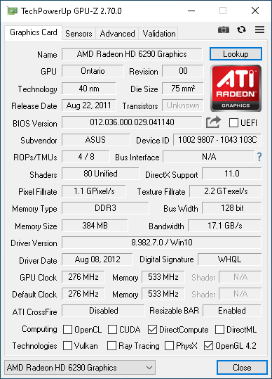

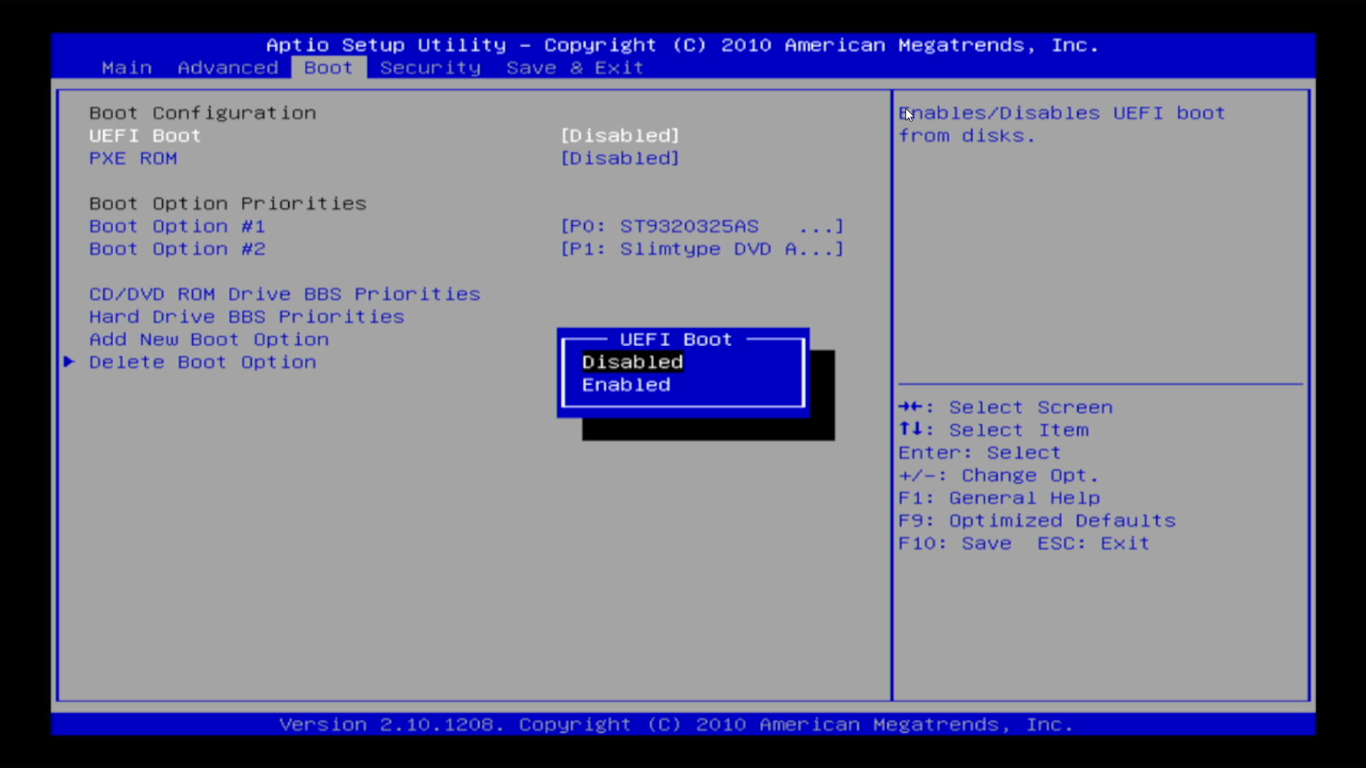

I have an Asus K43U laptop that have an Radeon HD 6290 IGP integrated GPU on it, the GPU-Z showed up that this GPU dosent support UEFI, but in the BIOS there is an option to enable UEFI. I am reinstalling Windows 10 on this laptop. Can I use UEFI without problems?

You can rest assured—you can use UEFI on this laptop even though the integrated GPU indicates it isn't supported; that refers to the boot mode itself.
However, when you enable UEFI boot, Windows needs to be set up for UEFI mode. I believe yours is currently in Legacy mode, so enabling UEFI might prevent Windows 10 from booting. Check if your drive (PO:ST9235) still appears in the boot list after enabling it, since it is a Legacy boot device.
If it doesn't appear, simply disable UEFI Boot in the BIOS again.

    The GPU-Z result is not the deciding factor for Windows installation mode. What matters is whether the firmware supports UEFI and whether the system can boot the installation media in UEFI mode. Older devices can support either BIOS or UEFI depending on firmware configuration, and Class 2 devices can behave as either BIOS or UEFI systems.

    1. UEFI support is determined by the laptop firmware Your BIOS screen shows a UEFI Boot setting, which indicates the laptop firmware supports UEFI booting.

    1. Enable UEFI Boot in firmware.
    2. Boot the Windows installation USB using the UEFI boot entry.
    3. Install to a GPT disk.
