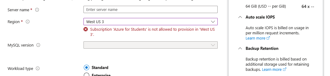

When attempting to create a Student Cloud, I get the following errer: 'Subscription is not allowed to provision"
Matthew A Foley 0 Reputation points
2026-09-12T16:20:33.0633333+00:00

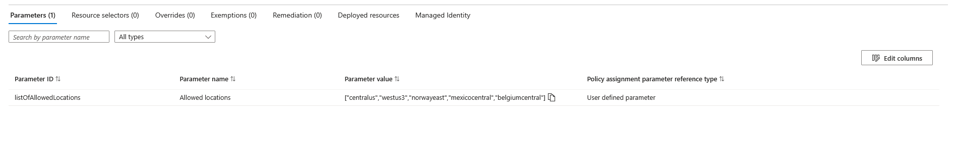

already checked with Azure IT and it is not a restricted area provision, as this message pope up with all regions. According to tech support "Based on this information, we have completed the subscription-level investigation within the scope of Azure Subscription Management Support (ASMS). Since the deployment is failing in a region that is already permitted by the subscription policy, the behavior does not appear to be caused by the subscription configuration itself.".

    If the same “Subscription is not allowed to provision” error appears in every region, and Azure Subscription Management Support has already confirmed that the subscription isn’t blocked by a regional policy, this is probably not a normal subscription policy issue. For App Service, that error can also be returned when the Microsoft.Web backend has an internal restriction on the subscription or offer type. In that case, changing region, resource group, or template won’t help because the block is evaluated by the App Service resource provider before provisioning.
    I’d ask support to move the case from Subscription Management to the Azure App Service / Microsoft.Web engineering team and have them check the subscription’s backend provisioning eligibility. Include the subscription ID, exact UTC timestamp of a recent failed attempt, region, App Service plan SKU, correlation ID, and the full deployment error.
    The important point is that ASMS has already ruled out the subscription policy layer. The next investigation needs to be on the App Service resource provider side, where only Microsoft can see or clear an internal provisioning restriction.

    Since Azure IT has already confirmed that the subscription is not restricted from provisioning in the selected regions, and the same error occurs across multiple regions, I wouldn't keep troubleshooting the region/allowed-location setting.
    The message:
    sounds more like an eligibility/provisioning check performed by the Student Cloud service than a normal Azure regional deployment error.
    A few things I'd verify:
    • Confirm that the subscription is actually an Azure for Students / Student Cloud eligible subscription and that it hasn't expired, been converted, or otherwise changed status.
    • Check whether the account is still eligible for the Student Cloud offer and whether there is already an existing Student Cloud/resource associated with the account.
    • If this is being created through a Microsoft/Student Cloud portal rather than directly through Azure, the portal/service may be performing an entitlement check that Azure Subscription Management Support cannot see.
    • Try the same operation with the account/tenant that originally activated the Student Cloud offer. Also check Subscriptions → Overview for the subscription type, offer, and status.
    Given that ASMS has already completed the subscription-level investigation, I'd escalate this to the Student Cloud / Education provisioning team rather than opening another generic subscription support request.
    When raising it, provide the exact error, subscription ID, account/tenant, timestamp, and the fact that all regions fail despite the subscription being permitted in those regions. Ask them specifically to check the backend Student Cloud provisioning/entitlement state of the subscription.
