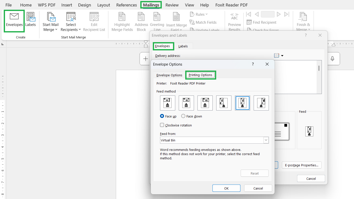

When I use the "Mailing" tag to create an envelope for a letter the envelope is properly laid out on the screen but prints in the wrong place. It juust started happening after several years of proper operation. How does one fix that?

    In the meantime, please go to Mailings > Envelopes > Options > Printing Options and verify that the envelope feed method and orientation are configured correctly. Also make sure the envelope is loaded exactly as shown in the diagram. In addition, confirm that the envelope size, paper source, and orientation in Word match the settings configured in your printer properties.
