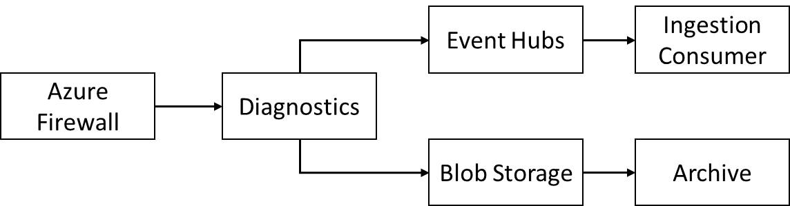

The architecture would then be:
Azure Firewall > Azure Monitor Diagnostic Settings > Azure Event Hubs > Consumer group > Your ingestion application
This avoids having to determine whether an hourly blob has changed or whether you've already processed part of the file. Your consumer can maintain its Event Hubs partition offsets/checkpoints and process the stream incrementally.
You can also configure multiple diagnostic settings/destinations if you need different use cases, for example, Event Hubs for streaming ingestion and Storage for long-term archival. Azure Monitor diagnostic settings support Storage, Event Hubs, and Log Analytics destinations.
One Azure Firewall-specific caveat is that destination support can vary by log category. For example, Microsoft's current Azure Firewall monitoring reference states that DNS Flow Trace Logs aren't supported with Event Hub as a destination, although Storage and Log Analytics support that category.
Azure Storage Queues: these aren't a native Azure Monitor diagnostic-settings destination for Azure Firewall logs. You could build an intermediate component that reads another supported destination and writes messages to a Storage Queue, but there isn't a direct Azure Firewall diagnostic setting → Storage Queue configuration.
Azure Firewall API: I also wouldn't use the Azure Firewall management APIs as a replacement log-ingestion API. Firewall traffic/resource logs are exposed through Azure Monitor diagnostic logging; the management APIs are for management/control-plane operations, not an incremental feed of Firewall log records.
For your stated requirement: reliably consuming Azure Firewall events incrementally without repeatedly reading partially updated hourly blobs, I recommend Event Hubs, assuming the specific Firewall log categories you require support that destination.
Keep Blob Storage in parallel if you also require inexpensive long-term archive/audit retention:
User's image This separates the streaming and archival requirements rather than trying to turn the archive format into a streaming interface.
