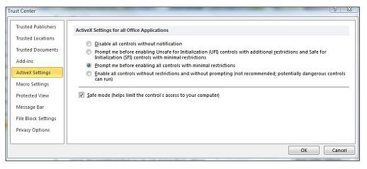

    4. Go to File > Options > Trust Center > Trust Center Settings > ActiveX Settings, and select Prompt me before enabling all controls with minimal restrictions. The button may be an ActiveX control, which is managed separately from VBA macro settings. Screenshot that shows the ActiveX Settings area.
