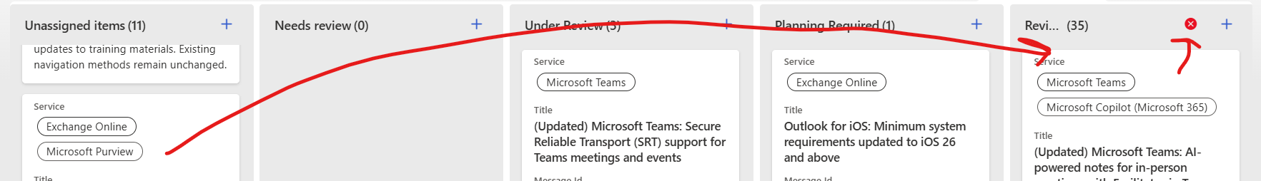

I’m running into an issue using the SharePoint Online Board view on a list with a custom choice column called “Internal Status,” which is used to define the board buckets. When I drag an item from any bucket into the Reviewed bucket, the following happens:
  • I drag an item into the "Reviewed" bucket.
  • The board view syncs.
  • An error icon appears (no details provided).
  • The item returns to its original bucket.
Here is a screenshot of the error:Screenshot 2026-09-08 110840
Now as mentioned above, this issue only seems to happen when moving items to the "Reviewed" bucket. Any ideas on what could be causing this error?

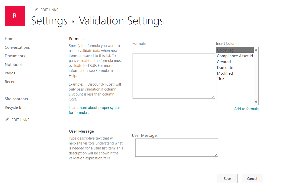

  1. Review list and column validation
  • In list select the gear icon > List settings > Validation settings, check whether a validation formula requires another field, such as Reviewed By, Review Date, or Comments, when the status is Reviewed.
  • Dragging a card updates only the bucket column, so the operation can fail if another required value is missing.

Chris LeMay 190 Reputation points
2026-09-08T23:25:32.5933333+00:00
Hi @Jay1 Tran
I ended up following your advice in the last step and creating a new board view. I think I found the potential cause. I forgot that I had customized the formatting JSON for the cards on this view (text wrapping for the fields displayed on the card. Something in my custom schema must be causing the issue, as when I moved cards around on the default board view, I did not run into the same issue.
As a side note, it looks like even though I get an error when moving an item, and the item appears to move back to the original column, if you refresh the page, the items have actually moved to the new column, so it appears to be a visual glitch?
Thanks!
Chris
