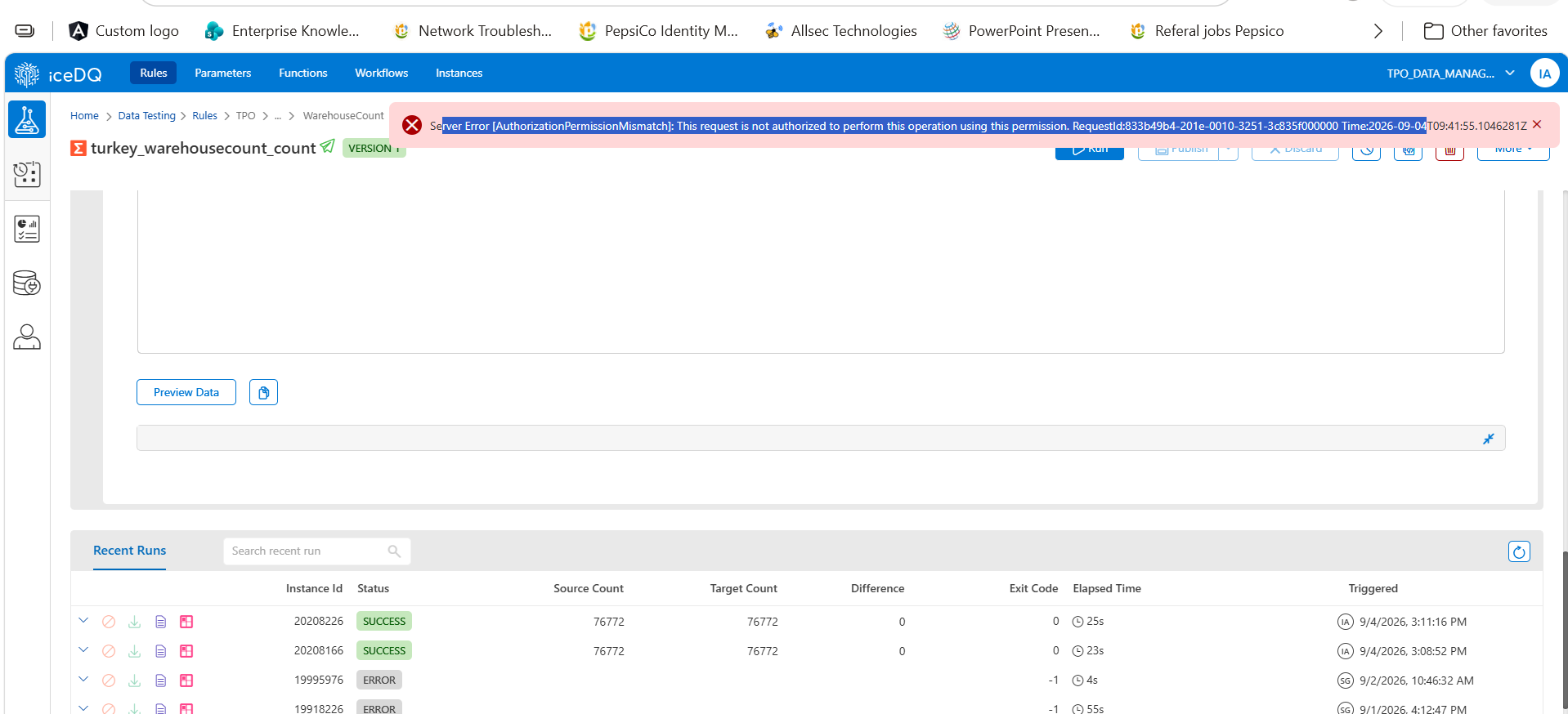

Aditya Jogwar 0 Reputation points
2026-09-06T07:27:18.79+00:00
While doing preview data from iceDQ to azure blob storage, we are receiving the above error as shown in the screenshot.
I am not able to attach the service logs here for reference (as it is a zip file). After restarting the icedq-connection pod, all the connections and APIs used to do preview data, executing the rule works.
Note : This issue is intermittent, and the connection used in iceDQ to connect to the blob storage is getting tested successfully. This rules out any permission specific issues. Attaching the screenshot of access control (IAM) from the storage account level.

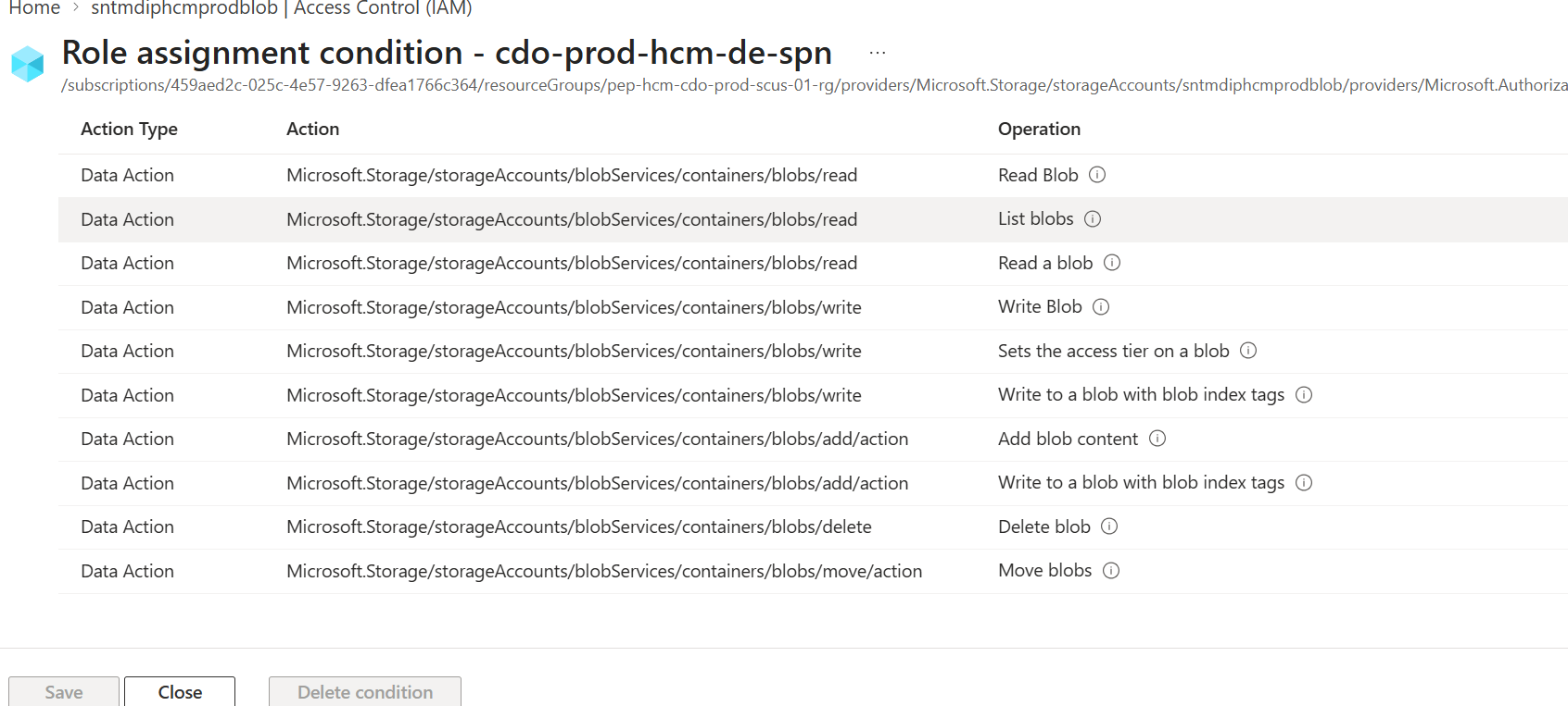

    2. Role assignment conditions
    One detail that stands out in the screenshot is that the service principal appears to have a Role Assignment Condition applied.
    Even if connection validation succeeds, Preview Data may perform additional operations such as:
    • Blob enumeration
    • Container enumeration
    • Metadata retrieval
    • Tag access
    • Temporary write operations
    If one of those operations falls outside the permissions allowed by the condition, Azure Storage can return AuthorizationPermissionMismatch for that specific request.

    4. Review the role assignment condition and verify that all Preview Data operations are permitted.
    5. Confirm that the identity has the appropriate data-plane role for the operations being performed, such as:
      • Storage Blob Data Reader for read-only access.
      • Storage Blob Data Contributor if any write activity occurs.
