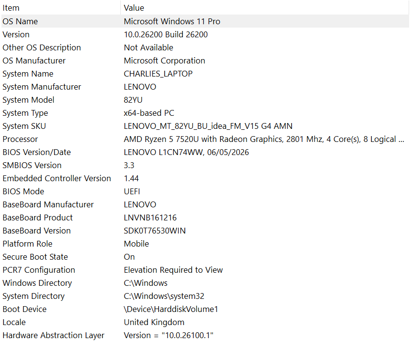

My laptop keeps restarting on its own when it is in sleep mode and when it is on.
This started after I reinstalled windows 11 with an installation usb.
I've already tried installing a bunch of drivers. I reinstalled my graphics driver two days ago. The restarting stopped for a couple of hours, but then my laptop crashed. AMD (of which I installed the graphics driver from) then gave me a popup saying that something went wrong. It didn't say much more than that tho
This is my info from msinfo32

    Please check to see if your laptop is producing any small Watchdog dump files, I will check those to see if they provide any insight into a potential cause of the system crashes.
    Open Windows File Explorer.
    Navigate to C:\Windows\LiveKernelReports
    If there are any Watchdog dump files in the sub-folders of that folder, copy the files onto your Desktop, then zip those up.
    Upload the zip file to the Cloud (OneDrive... etc.), then choose to share those and get a share link.
    Then post the link here to the zip file, so I can take a look for you.
