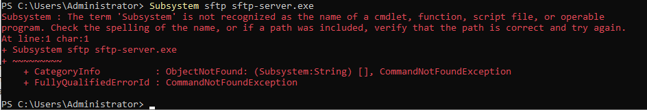

I have the SFTP issue on the client to link to Server 2022. How to fix it and find out the path below?

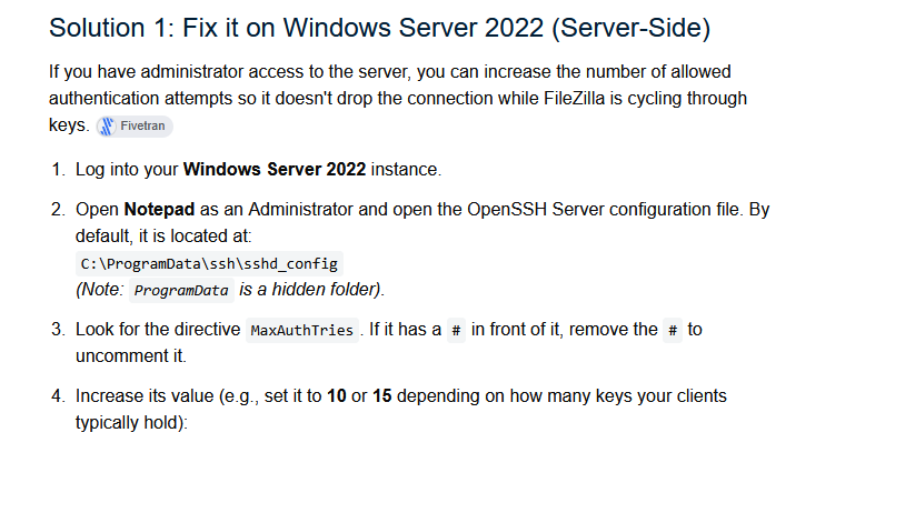

    For OpenSSH SFTP on Windows Server 2022, the main configuration file path is:
    %ProgramData%\ssh\sshd_config
    ProgramData is a hidden folder, so the full default path is:
    C:\ProgramData\ssh\sshd_config

    1. Open C:\ProgramData\ssh\sshd_config with an administrator account.

    3. Check that the file has no trailing spaces and that this entry is present:
         Subsystem sftp sftp-server.exe
