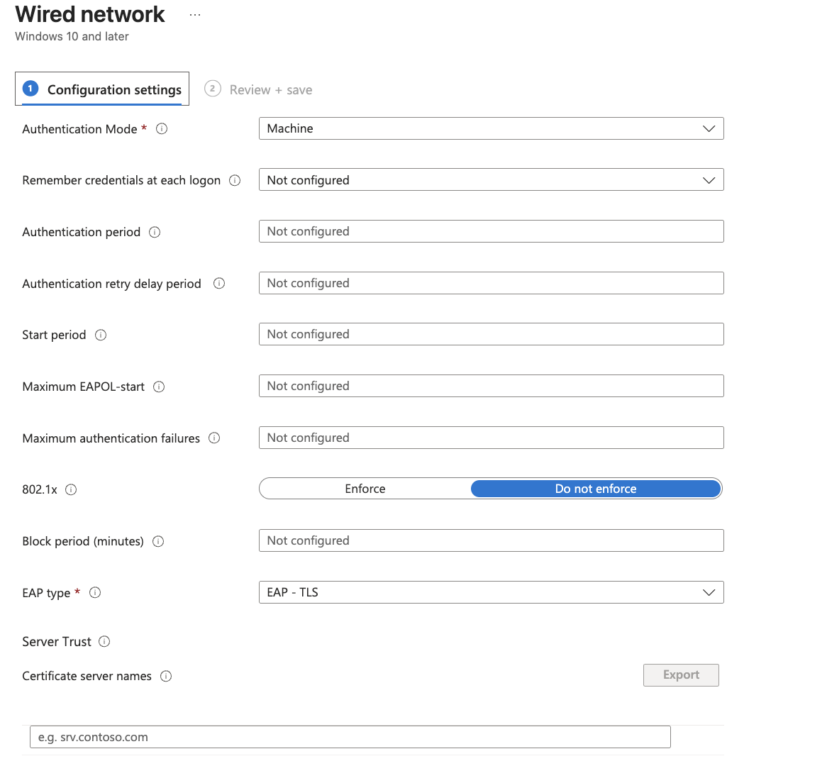

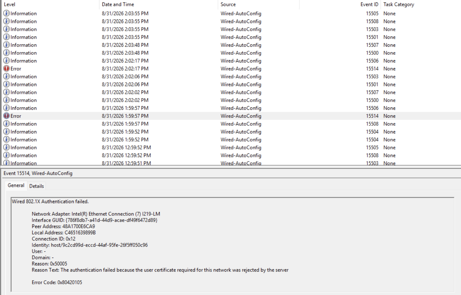

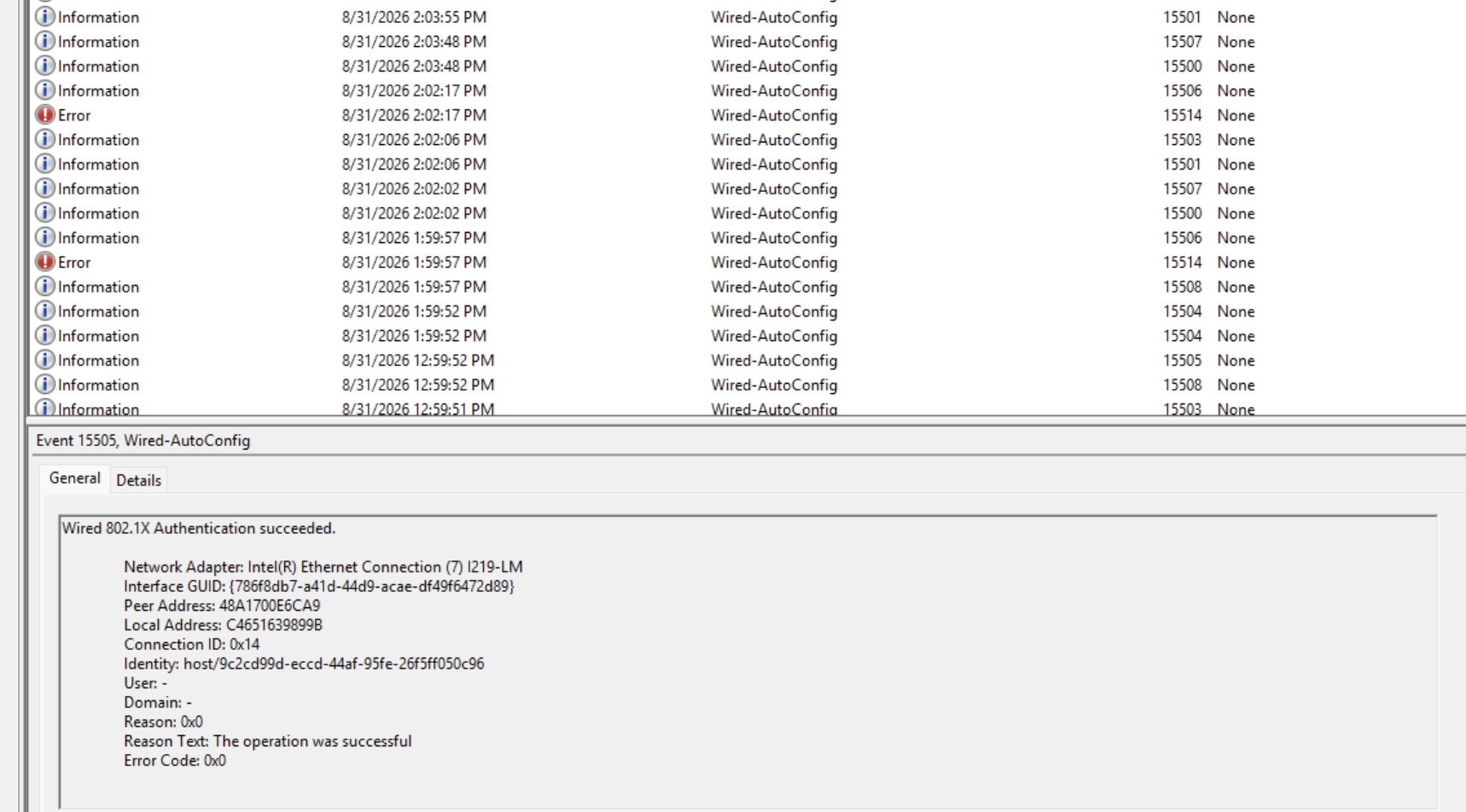

i use computer authentication using certificate for my 802.1x and all is working fine. But i got some complain from some user that suddenly they loss access. When i check in the event viewer, the windows try authenticate using user certificate but after some minutes then the authentication is succeded. My question is why suddenly the windows use user certificate for a short period?

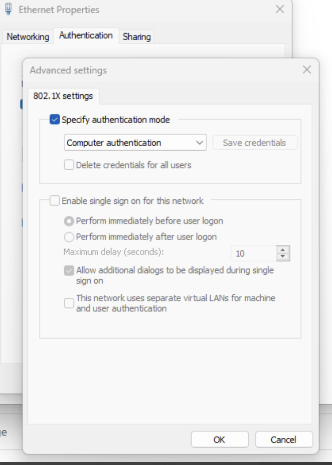

    To prevent these transient failures, you should verify that in the Ethernet Properties > Authentication tab > Advanced settings, the “Specify authentication mode” is set to “Computer authentication” and that “Enable single sign on” is disabled. If SSO is required in your environment, you’ll need to ensure that both machine and user certificates are properly issued and trusted by the NPS/RADIUS server, otherwise you’ll continue to see these short-lived failures. Also confirm that your Group Policy under Computer Configuration > Windows Settings > Security Settings > Wired Network (IEEE 802.3) Policies enforces machine authentication only, as this overrides local adapter settings.

    The event details shown do not indicate that Windows successfully switched to user-certificate authentication. The successful event still shows Identity: host/..., which is the computer account identity, not a user identity.

    1. Wired 802.1X issues should be verified in the Wired-AutoConfig operational log
      Check Event Viewer (Local)\Applications and Services Logs\Microsoft\Windows\Wired-AutoConfig/Operational. That is the correct log for wired 802.1X authentication behavior.
