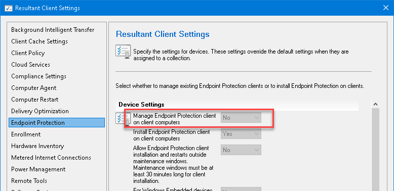

Under Assets and Compliance - Endpoint Protection - Antimalware Policies, the machines are excluded from the policies.

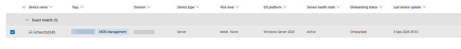

In the MDE portal under System - Settings - Enforcement scope, Enable Configuration Management is enabled for Windows Servers with the tag MDE-Management.
In the MDE portal, the machines we want to migrate have the MDE-Management tag.

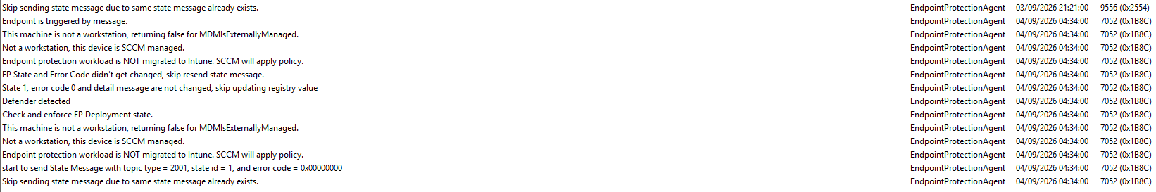

If I run the script MDEClientAnalyzer, I see that the Enrollment status says 'Device is managed by SCCM Agent (4)'
I have already restarted the servers, all the changes were made more than 24 hours ago.

    For Windows Server, first verify that the servers are actually onboarded to MDE and that the MDE sensor is healthy. In the Defender portal, check the device's MDE onboarding status and make sure the device is represented as an onboarded Windows Server rather than merely being visible through another management/inventory mechanism. Also verify that the MDE-Management tag is actually present on the device that MDE is evaluating. Your enforcement scope should include Windows Servers and the scope/tag combination must include those machines.

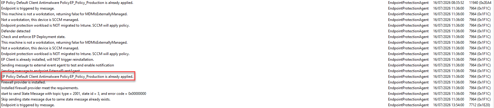

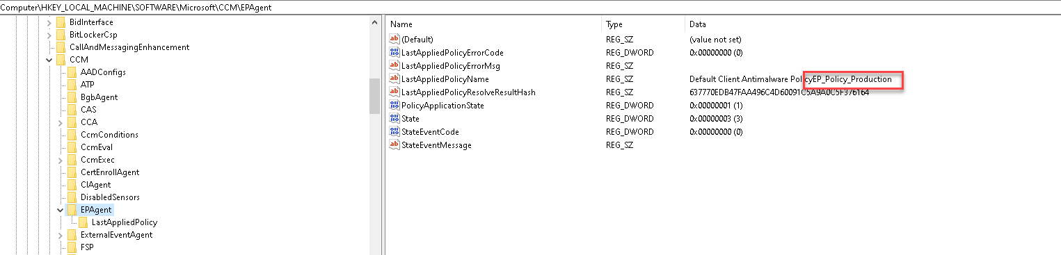

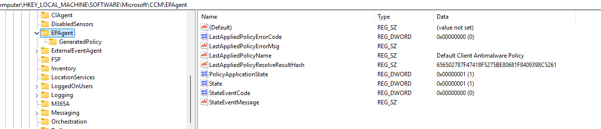

    The important part in your case is the existing ConfigMgr Endpoint Protection policy state. I would not rely solely on the collection exclusions. Check the local server for the ConfigMgr Defender policy that remains in effect. Run Get-MpPreference and inspect the Defender configuration, and also check the relevant ConfigMgr Endpoint Protection policy information under C:\Windows\CCM\Logs, particularly EndpointProtectionAgent.log, EndpointProtectionReporting.log, and PolicyAgent.log. If ConfigMgr is still applying an Endpoint Protection policy, the MDE configuration-management transition can be prevented even though the console reports the deployment as "Unmanaged."
