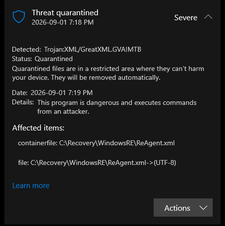

Windows Microsoft Defender identifying "Trojan:XML/GreatXML.GVA!MTB" in C:\Recovery\WindowsRE\ReAgent.xml->(UTF-8)
B V 0 Reputation points
2026-09-02T00:31:59.41+00:00

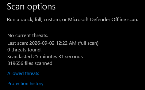

I've run other antivirus (Malwarebytes, Hitman Pro, ESet) with no findings save for when ESet found a trace (tracking cookie) from Microsoft Edge- a browser I do not use. I am unclear if the trojan is a false positive, but as I am unable to run an Offline Scan due to the page defaulting to the Boot Menu, it would not be unwise to treat it as a genuine positive.
I had to reboot from an ISO at the beginning of August related to my attempts to find what was consuming my memory and causing my fans to overheat. The current hypothesis that the Win11 update had caused issues; after a stepdown to Win10, the issues appear to be solved. However, the ISO was from a desktop and I needed to surplant missing functions (i.e. touchpad device drivers) from other sources.
The trojan itself only appears after a Windows Defender Offline Scan is attempted, and only appears with a Microsoft Windows Defender Full Scan. Once quarantined and removed/restored, it does not trigger a response from the scans.
Please advise.

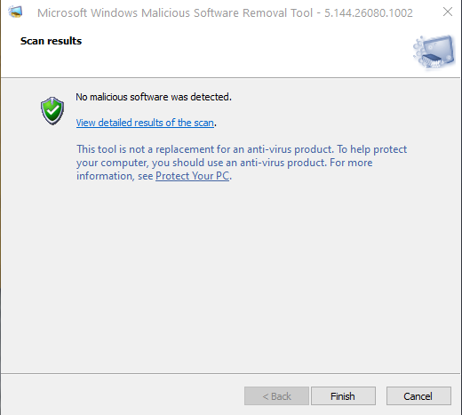

EDIT [09.01.26: 2038] : Ran the Malicious Software Removal Tool Quick Scan- no threat detected. Running Full Scan, will report back with results.
EDIT [09.01.26: 2318] : Ran the Malicious Software Removal Tool Quick Scan twice to the same result. Please advise.
