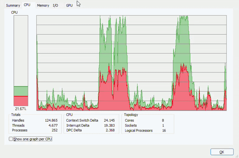

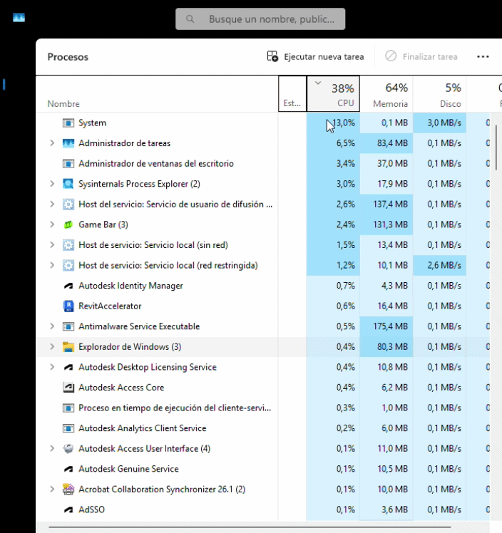

My computer has constant lag spikes since a few days ago. At first I thought it was hardware related as it lags even at startup, but I could not find the problem with diagnostic tools and temps seemed fine (46ºC) with HWmonitor. After registering a spike with the tools open, I saw CPU went to 100% and memory to 80%. Even if I close every other app other than the monitoring tools it spikes to 60%.
Through process explorer and task manager, I saw most, if not all the load, comes from "System", "Antimalware Service Executable", "Service Host" and the like. I tried to locate the origin of each process and all seem to originate from legit locations and have the correct names.
What could be the problem? How would I go about fixing it? Attached are some recordings.

    Start by identifying which of those Windows processes is actually driving the spikes, because System, Service Host, and Antimalware Service Executable are umbrella processes and the fix depends on which one is responsible.
    1. In Task Manager:
      • Open Task Manager and sort by CPU on the Processes tab.
      • If needed, go to Details and add the PID column.
      • If Service Host or WMI Provider Host (WmiPrvse.exe) is involved, note the PID.
    2. In Resource Monitor:
      • Open Start > type resmon > open Resource Monitor.
      • Go to the CPU tab.
      • Sort by Average CPU and watch which process stays at the top during a spike.
    3. If System is the main offender, use Process Explorer:
      • Run Process Explorer as administrator.
      • Right-click System > Properties > Threads.
      • Select the high-CPU thread and choose Stack to see what functions are running.
      • For better stack results, configure symbols in Process Explorer by installing Debugging Tools for Windows, then in Process Explorer go to Options > Configure Symbols, and set Dbghelp.dll to C:\Program Files (x86)\Windows Kits\10\Debuggers\x64\dbghelp.dll.
    4. If Antimalware Service Executable (MsMpEng.exe) is one of the top consumers:
      • Check whether Microsoft Defender Antivirus real-time protection is the source of the high CPU usage.
      • Review other software on the machine as a possible cause first.
      • If needed, use the Microsoft Defender Antivirus Performance Analyzer first, then Process Monitor, and finally Windows Performance Recorder (WPRUI or WPR command-line) if the analyzer does not identify the root cause.
    5. If Service Host (svchost.exe) is the main source:
      • This often means one hosted service is causing the spike.
      • Open an elevated Command Prompt.
      • Break the suspected service out into its own svchost process:
             sc config <service name> type= own
      • Restart the service.
      • Run:
             tasklist /svc
        to verify it is running in its own svchost process.
      • Then monitor CPU again to identify the exact service.
      • Important: after testing, revert it:
             sc config <service name> type= share
        then restart the service.
