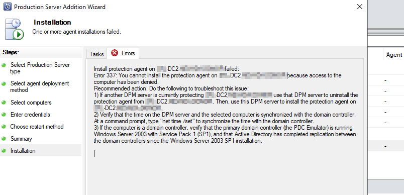

Hi All,
We have completed MABS installation and are working on the DPM agent installation for the protected servers. We have successfully installed the agents for the few servers from the MABS console.
We are stuck at agent installation for the DC servers. We have tried both ways, and neither way is working.
  1. Push the agent from MABS console
  2. Install the agent manually and attach the agent
    run the below command to register the agent
    SetDpmServer.exe -dpmservername <Our DPM Server Name>
When we push the agent from the MABS console, we get the following error. None of the recommended troubleshooting actions in the below image helped to resolve the issue.

    Installing protection agents on Domain Controllers frequently encounters Error 337 during console push due to AD hardening.

    If Manual Attachment or Push Still Hits Access Denied:
    • DCOM Security Permissions on DC: Run dcomcnfg on the DC > expand Component Services > Computers > My Computer > Properties > COM Security tab. Ensure ANONYMOUS LOGON and Authenticated Users have Remote Access / Launch permissions.
    • Verify Admin$ Share Access: From the MABS server, verify you can access \DC2\Admin$ using the Domain Admin account without an access denied prompt.
    • Remote Registry & MSDTC Services: Verify that both Remote Registry and Microsoft Distributed Transaction Coordinator (MSDTC) services are running on the DC.
