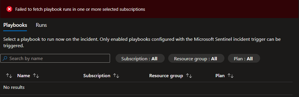

We are an MSSP managing multiple Microsoft Sentinel workspaces across separate customer tenants via Azure Lighthouse. As of today, the Automation / Active playbooks view fails to list playbooks and returns "Failed to fetch playbook runs in one or more selected subscriptions". The "Run playbook" panel on an incident also comes up empty.
User's image This started suddenly and affects more than one tenant, with no configuration changes on our side. I found this thread reporting what looks like the same behaviour today:

    Based on the checks already completed, this looks more like a service-side Sentinel/portal issue than a playbook configuration or RBAC problem.
    The main indicator is that the issue started suddenly across multiple independent tenants at approximately the same time, without any configuration changes, and another user has reported the same behavior.
    I would only suggest two additional checks:
    Verify whether automation rules are still triggering the playbooks successfully. If they are, while Active playbooks and Run playbook remain empty, the issue is likely limited to playbook enumeration in the portal.
    Check Azure Service Health and capture the failed browser request/correlation ID from Developer Tools.
    If there is no related Service Health notification, I would recommend opening a Microsoft support case, including the affected tenant/workspace IDs, UTC start time, screenshots, and correlation IDs.
    I would also avoid recreating playbooks or changing RBAC at this stage, since the simultaneous multi-tenant behavior strongly suggests a backend issue.
