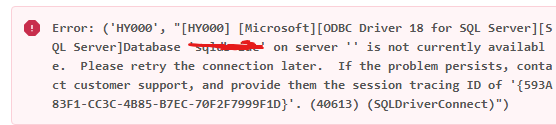

we have so many scheduled job which interact with azure sql database few are failing and few are succeeding , all are configured with same database.
see below ss for your reference

Check the compute tier. If it's Serverless, auto-pause likely explains it, the first connection after idle returns 40613 while it resumes. Raise the auto-pause delay or move to provisioned.
Check Resource Health to see if failures line up with platform events. Persistent failures while the DB shows Online = platform-side.
Add retry logic with backoff (3–5 retries) on all jobs.

    The screenshot confirms Azure SQL error 40613:“Database is not currently available.” This can occur when the database is temporarily unable to accept connections. However, the error alone does not confirm the underlying cause, so further investigation is required. Similar cases may involve maintenance, failover, resource pressure, or another database availability event.
    As an immediate mitigation, please enable retry logic with exponential backoff for database connection attempts. Also verify the database status, Azure Service Health, Resource Health, and database resource-utilization metrics during the affected period.
