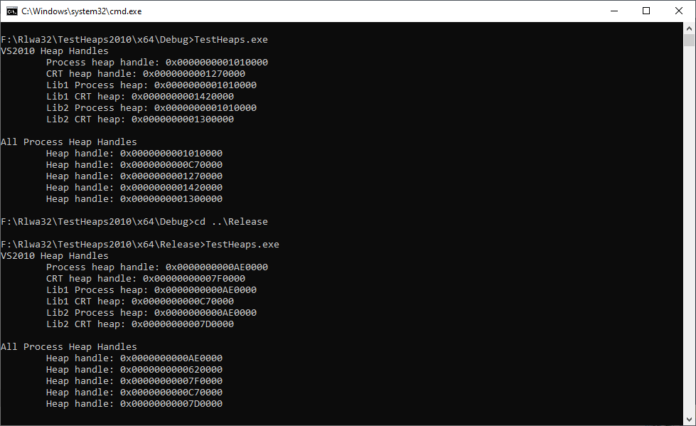

    I used a console application that loaded two dlls to test heap handles with GetProcessHeap and the CRT function _get_heap_handle. The console application and each of the loaded dlls called both functions.
    These are the results from running the test with a V2010 build and a VS2022 build.
    VS2010 results dynamic linking with CRT-
    VS2010 dynamic CRT

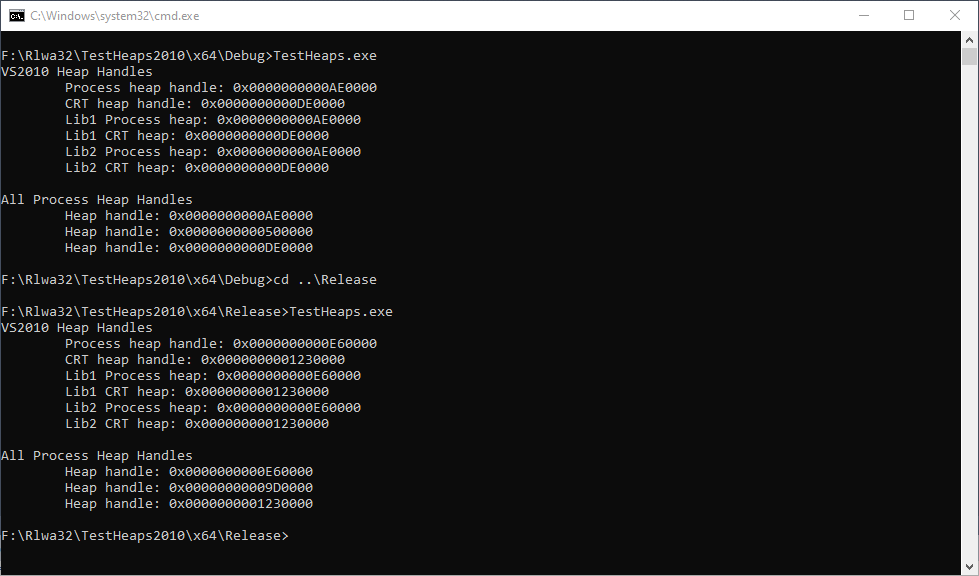

    VS2010 results static linking with CRT -
    VS2010 static CRT
    When dynamically linking to the CRT VS2010 created a single separate heap distinct from the process heap for the console application and the loaded dlls. When statically linking VS2010 created several separate heaps for the application and the loaded dlls that were distinct from the process heap.

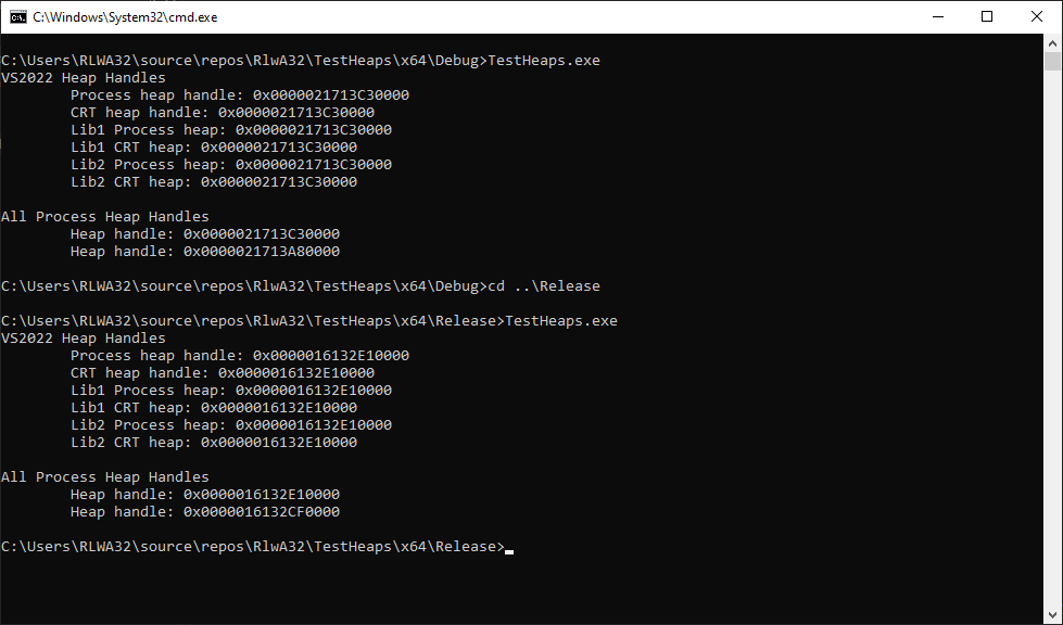

    VS2022 exhibited completely different behavior.
    VS2022 results dynamic linking with CRT -
    VS2022 dynamic CRT
    VS2022 used the process heap for all as opposed to the VS2010 which used a single separate heap (not the process heap) for all.

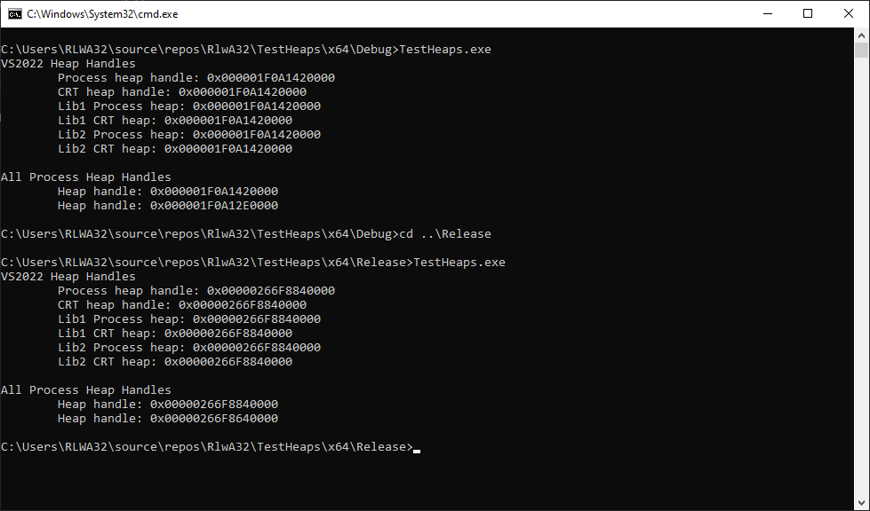

    VS2022 results static linking with CRT -
    VS2022 static CRT
    Interestingly, the VS2022 call to _get_heap_handle returned the same heap for all (the process heap) even when linking everything with /MT(d).
    I'm not aware of any supported options to change this implementation.
