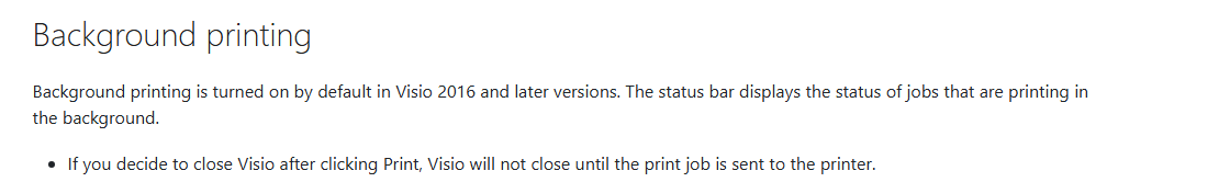

Based on my research, it appears that Visio does not provide a dedicated interface to view or cancel individual background print jobs once they have been queued. According to Microsoft's documentation, Visio will not close until a print job has been sent to the printer after you click Print. This suggests that Visio maintains its own background printing process before the job is fully handed off to the Windows print queue.
You can refer via: Print dialog box in Visio

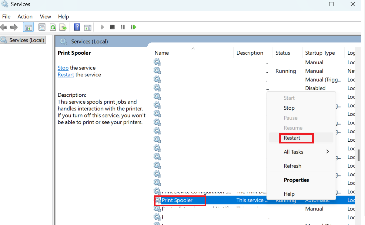

To troubleshoot this, you could try to:
  • Close Visio completely, or end VISIO.EXE from Task Manager if it does not close normally. This may clear any pending background print jobs.
  • Restart the Print Spooler service by opening Run (Win + R), typing services.msc, locating Print Spooler, and selecting Restart. This can help resolve communication issues between Visio and the printer.
You could give this a try and let me know if this helps.
