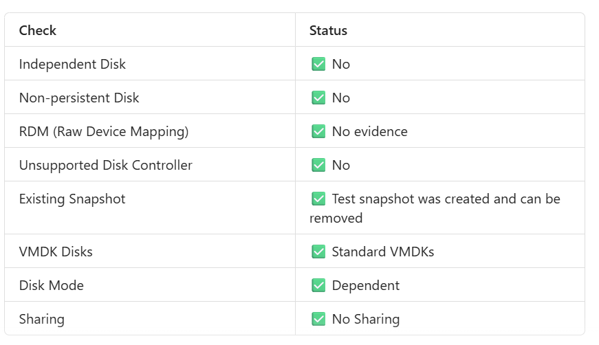

    Error 110099 is typically a failure during the replication enablement stage, rather than VM discovery. Since the VM is discovered successfully but never appears under Replicating Machines, the issue is most likely occurring when Azure Migrate attempts to configure replication.
    I recommend checking the Azure Migrate appliance logs immediately after reproducing the error to identify the underlying failure. Also verify that the VMware VM does not use any unsupported configurations such as:
    • Independent or non-persistent disks
    • Raw Device Mappings (RDMs)
    • Unsupported disk controllers
    • Existing snapshots or other unsupported storage configurations
    As an isolation test, try enabling replication for a different small VMware VM with a standard configuration. If that VM replicates successfully, the issue is likely specific to the original VM. If multiple VMs fail with the same error, review appliance health, vCenter permissions, VMware connectivity, and the Azure Migrate target configuration.
