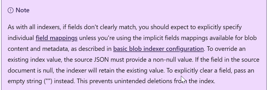

    1. For JSON blob indexing, if a source JSON field is null, the indexer retains the existing value in the index.
    2. To explicitly clear a field through the indexer, the source JSON must send an empty string ("") instead.
    3. If the field mappings don’t match clearly, explicit fieldMappings can be used, but that does not change update semantics.
    4. If full document replacement is required, the supported document action with that behavior is upload, which is available when pushing data to the index through REST API or an SDK.
