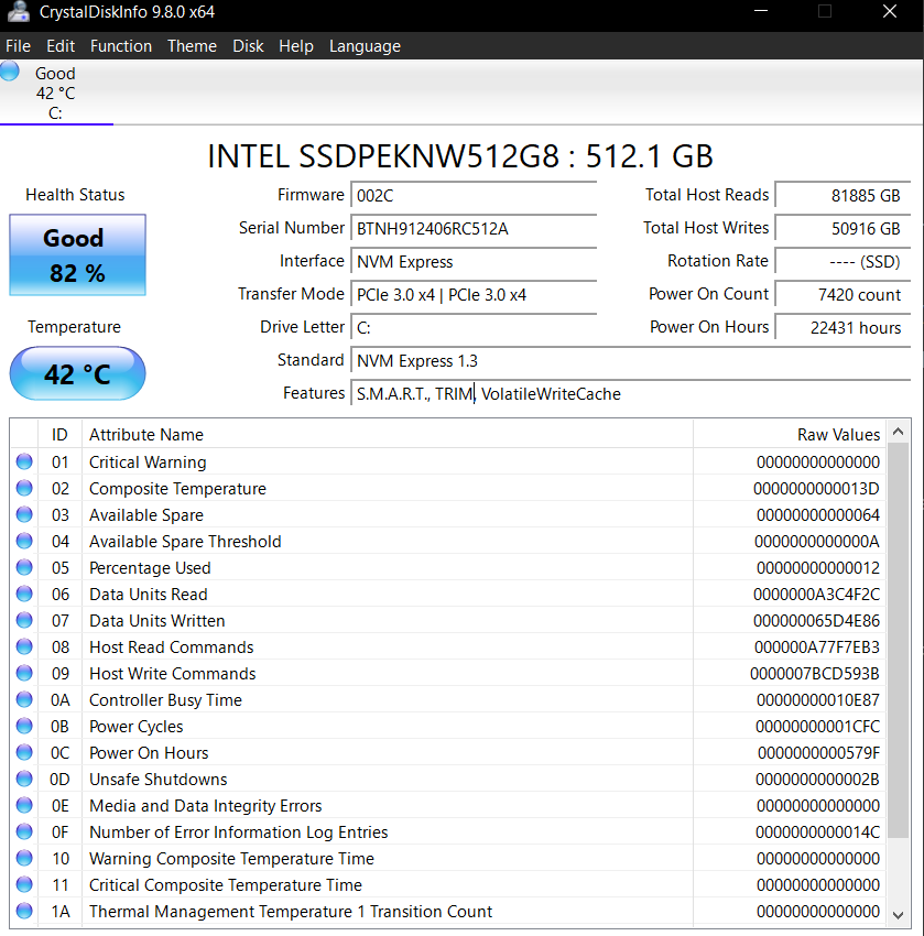

  • CrystalDiskInfo looks ok

I checked the dumps. The KMODE_EXCEPTION_NOT_HANDLED crash occurred in the storage/NVMe path (volmgr.sys, storport.sys, stornvme.sys), while the second crash was DPC_WATCHDOG_VIOLATION. This points more toward SSD firmware/storage or chipset drivers than RAM.
Your SSD SMART looks normal: 82% health, 42°C, and no media errors. However, the Intel 660p is still on firmware 002C, which is quite old. I suggest backing up your data first, then updating the SSD firmware with Solidigm Storage Tool:
https://www.solidigm.com/support-page/drivers-downloads/ka-00085.html
Also update the laptop BIOS, AMD chipset drivers, and AMD/NVIDIA graphics drivers from ASUS:
https://www.asus.com/support/faq/1035376/
Disclaimer: This link points to a non-Microsoft website. While the content appears accurate and safe, the site may contain third-party advertisements. Please distinguish between advertisements and official download links to avoid accidentally clicking on content that might promote PUPs/PUAs (Potentially Unwanted Programs). It is recommended to verify the source and file name before downloading or installing any files.
For now, avoid repeatedly running chkdsk /r. After updating the firmware/drivers, run chkdsk C: /scan and see whether the BSOD returns.
Microsoft reference: https://learn.microsoft.com/en-us/windows-hardware/drivers/debugger/bug-check-0x133-dpc-watchdog-violation
At this stage I would update the SSD firmware and drivers first, rather than replace the SSD immediately.

  3. Rong Jie 20 Reputation points
    2026-08-25T14:39:47.2666667+00:00
    Hi TaoLi,
    Didn't know that my SSD firmware was that ancient. I updated to 005C and ran chkdsk C: /scan, it seems ok now
    I don't know if I should/need to run chkdsk C: /f /r again
